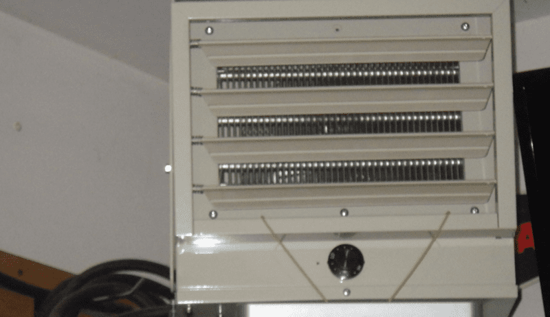

I don't paint cars but I'm not fond of an open flame or glowing coils in my garage. That could be due to dads garage burning down way back.
My garage is only about 3600 cu ft, ceiling is 6" insulated, and a R13 rated 16 ft. door. I bought a 7500 watt Farenheat 4 or so years ago. It's wired for 6250 watts, corded, and hangs on a hook so I can move it if needed. It has no glowing coils and can keep temps at short sleeve easily when I want it. Lol, one good thing about a small garage. I probably only needed the 5000 watt model. Even those are running 300+ bucks right now. There may be other brands that heat similar. Dayton's model appears to be the same as Farenheat.
