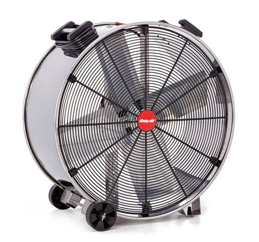

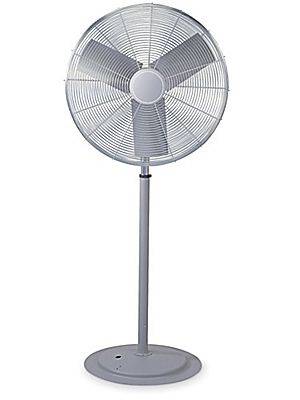

I have a commercial grade 30"($125 at Lowe's) stand fan. I put it by the garage exit door(to outside) and open my (rollup-style) garage door about 4"....turn that thing on high speed and within a minute or two it sucks all the smoke and stink right out. Works good for welding or something or like when I was working on the rear end of my car and got that Ford additive stench everywhere!
Mine...

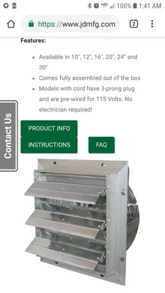

These work awesome too..
.. if you don't want to go the permanent fan-in-the-wall route

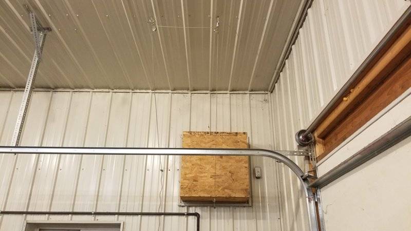

I have the 30" one installed in my shop. Moves like 4000cfm. It works awesome to remove fumes. I love it in the summer. Turn it on after it cools of in the evening, open a couple windows and keep the bugs out!
I have a box built for it on hinges with 1" rigid foam and weather striping for the cold months. It has a pulley system to open it easily if I'm working on snowmobiles and need to evacuate to 2 stroke smoke.
