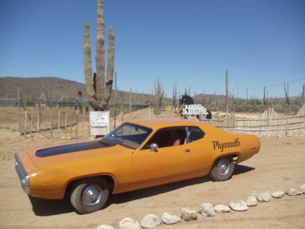

Completed a 4,600 mile road trip in a similar car this fall ('72 Satellite Sebring Plus, 318 CID, 904, 2.71 8 1/4 rear end) Gas mileage was 15, 16, 17, 18 with an overall average of 17.3 MPG. I don't believe mechanically you can increase that much more. Cruising at about 70 MPH (non-stop) seems to net the best mileage. But I am also always looking for ideas to increase gas mileage so my eyes and ears are wide open (my road trips are extensive).
