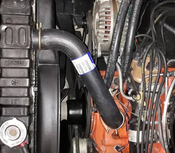

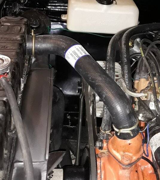

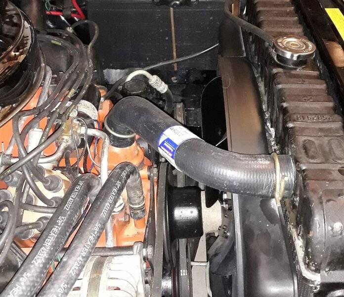

I ended up using a Gates 20511 . Its shaped a little closer to OEM , But not 100% dead on .
I am still working on finding one shaped much closer to the original
