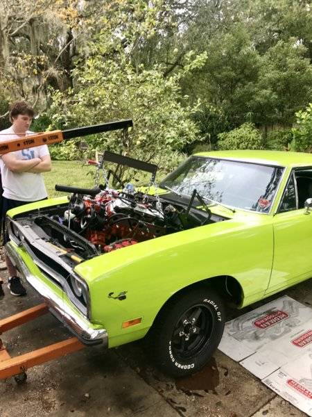

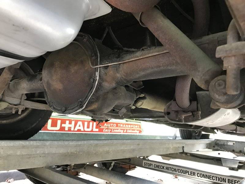

Over the last 2 years, I’ve converted my 1970 318/904 Belvedere to a 440/727 road runner clone. With my engine swap complete, I jacked up the rear end, marked the tire and u-joint and spun the tire 2 rotations. The u joint made 2.75 rotations so it looks like I have a 2.76 gear. The rear end is a 8 1/4 (not 7 1/4).
Well that’s great on the highway, but no fun light to light. What is a good middle ground gear that will be fun 0-60 but tolerable on Power Tour? 3.23? 3.55? Other? I don’t have any desire to go to a 8 3/4 at this time if ever. Don’t have the funds left to go gear vendors either. Plus It’s a car show car not a race car.

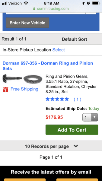

I'm definitely no search wiz, but I couldn't find a listing for 8 1/4 gears at summit or jegs.

This is great advice guys. Thanks for taking the time to respond. I did find one gear (3.55) for an 8 1/4 Belvedere at summit.
Are there different spline counts?
That would be 23 spline, NOT 24.
