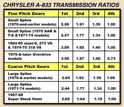

Made in cast iron and aluminum case for a-bodies, iirc just cast iron for b-bodies.

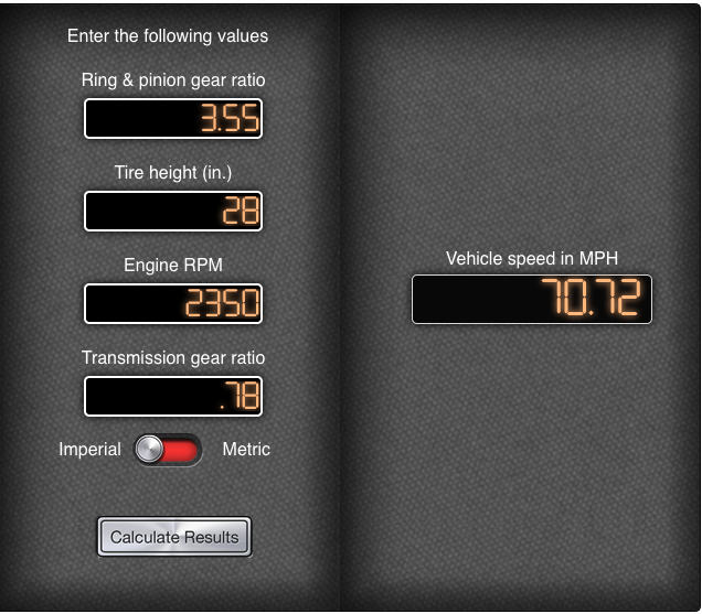

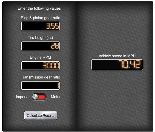

BUT, the unit is strong as hell, and it does work very nicely as an overdrive. Yes, it is "only" .78 to 1, but I found with my 3.55 rear it worked very nicely. I always left it in auto mode and I was happy with it. My 70 Road Runner has a .70:1 overdrive, so it is a more "steep" overdrive, but the GV worked OK with my 3.55 rear in my 73.

Other options are to convert a A833 to an overdrive (Passon Performance does this), but then you end up with 3 gears and OD (I've done this too, and it works well). If you ask me about a choice between a A833 and GV, or a Passon Oberdrive built into an A833, I'll pick the GV OD. It gives you "standard" performance with the four speed plus an extra gear. The Passon setup works well, but you get one fewer gear and about the same OD gearing.
