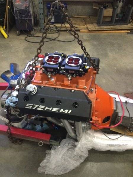

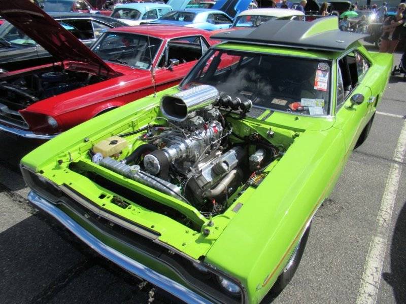

Merkel put this blown stroker pump gas engine together 10 years ago.
