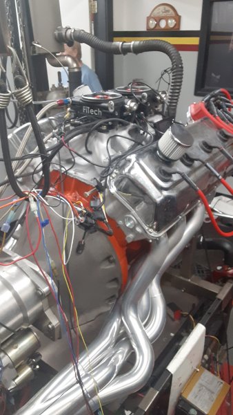

What bellhousing are you using? The 69 and older cars use a cast iron bellhousing with a 143 tooth 11 inch clutch 8 bolt flywheel. 70 and 71 cars use an aluminum bellhousing with a 10.95 inch clutch and a 130 tooth 8 bolt flywheel. My Hemi on the dyno with a 130 tooth 8 bolt flywheel and an aluminum bellhousing.

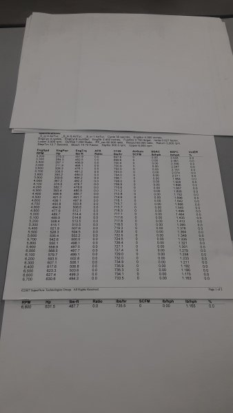

Nice, what did it make for power?
