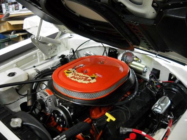

I fabricated my own dust shield and used a mini starter mounted on the drivers side.
When I started my swap I found a cheat sheet done by Herb McCandless. I have bolt in exhaust manifolds with heat shields. If you didn't know that the 5.7 wasn't available in 1969 my car could pass an OE inspection. I have this engine detailed like a production line install. I love it when people ask me how I got a serpentine on a Gen II Hemi. Most never realize.
I'd love to see more of your build, and Air cleaner set up.

What intake are you using?
I have the Mopar Performance that came on the early 5.7 crate motors. I put the coil packs under the intake and that was before Mod Man had theirs available. EFI's only had one throttle body. If I did it now I would have gone a different route. I did A LOT of custom fabrication for the look and it is simpler now. Two fours under an air cleaner would look so much cooler.
