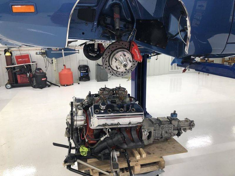

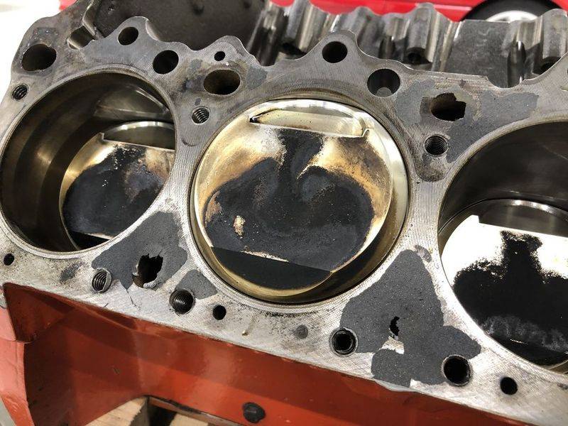

Finally got this out and started taking it down.
Pretty much as expected. 9-1 pistons but look like .050 in the hole (just guessing) Would be surprised if it's much better than 8.5-1 actual.
Cam is a Comp "Mutha thumpr" (not sure why that name annoys me so much) 235/249 107. Not a great match for single valvesprings. Well these at least. I'll test them tomorrow but I can open them with the palm of my hand. Feels like the guides are sloppy and the ports/bowls make me sad.
Have the time so I'm going to port them myself. Would go with edelbrocks but feel the port volume may be a bit big (or bigger than ideal) for the displacement.

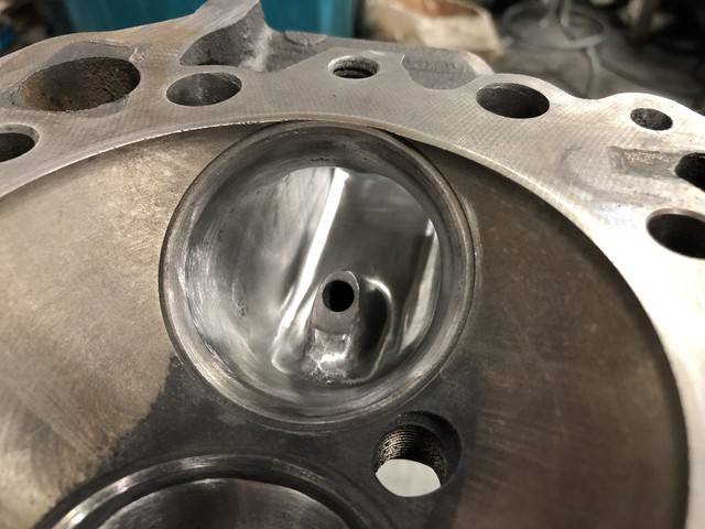

I'm making a bit of progress on the heads. About 10 hours in so far. Looking better to me but I've never ported heads before so I guess we will find out when I get them on a flow bench. I concentrated on bowl work but also raised the port .090 to match the Edelbrock intake.

We usually find it's better to install & rough size the new Valve Guides FIRST.... so we can also rough in our new Valve Seats concentricity as well before we do our Port work ?
That way we can Port down to the NEW Valve Seats ?
Just say'in....
no fun when now you go get the Guides and Seats redone only to find out your Porting is now off to one side vrs the new seat work ?
The whole purpose in Porting is to allow the Port to "present" the airflow to the seat angles ?

Sounds right but I removed a ton of material around the guide boss and bowl, and raised the port roof which was going to be done either way. Of course there will be more to do after the guides/valve job.
Can't imagine the valve seats are going to move a hundred thou in any direction and if they stay in the same general area I don't think it's going to be a problem.
Maybe I'm wrong, like I said, have never ported heads before. Thought it would save some money to rough them in rather than pay a machine shop the same amount of hours.

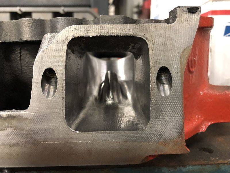

Well I ended up spending 16 hours on the heads and they are done for now. (or until guides/valve job are completed).
Didn't do a ton on the exhaust side. Short turn radius is strange, almost hooked rather than a consistent radius but I didn't alter that shape.
