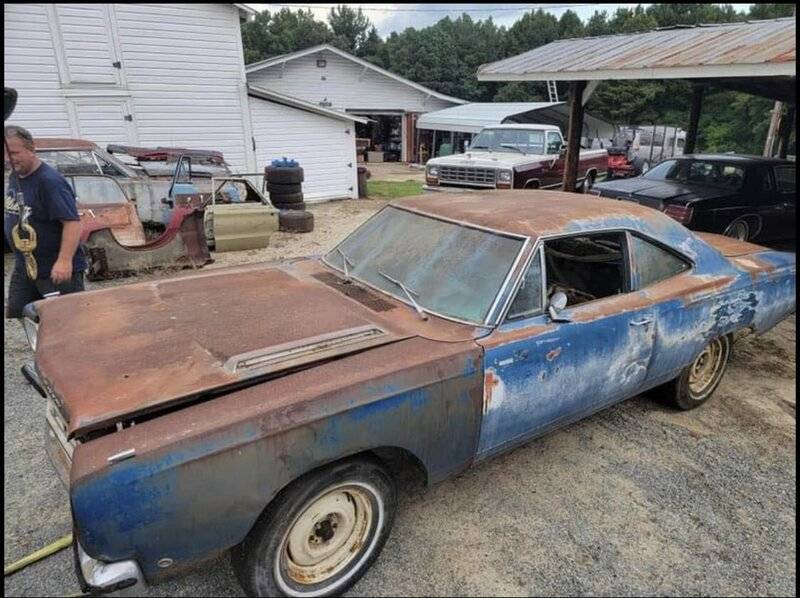

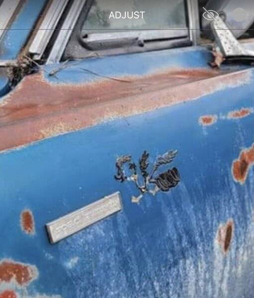

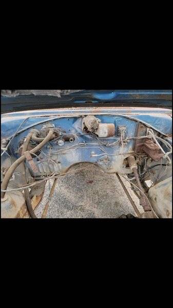

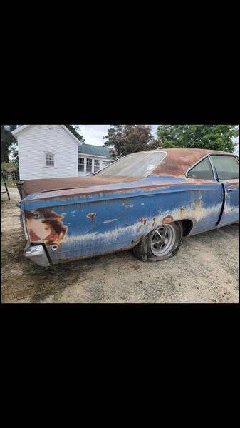

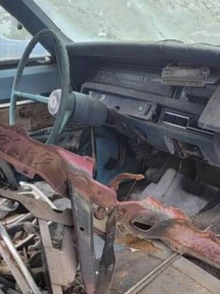

what’s left of the tag is on the car. Don’t know if anything can be gleaned from doing a pencil shading from the back. May be a build sheet in the car. Don’t know. Seats haven’t been removed. It’s unrestored and obviously a road runner though. A four speed with factory AC at that
View attachment 1231807 View attachment 1231808 View attachment 1231809 View attachment 1231810 View attachment 1231811
You are better off trying to get a rubbing from the back of the tag, doing your own homework and and working with someone that KNOWS tags for your specific year and plant before spending money and asking someone to make a tag.
A tag maker makes money from selling tags. A tag maker does not make money from having the knowledge on how to make accurate tags. If that were true, tag makers would not make bad tags. It's up to you, not them, to know what is right for your car.
