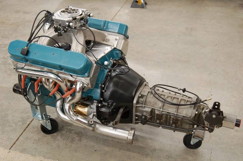

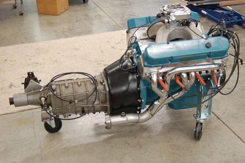

My '65 Coronet has been sitting in the corner for the past year waiting for its new engine. The engine was built last year and run on the dyno but I've been super busy with other projects so I just never got it installed. Engine is a 496 (426W with 4.25 stroke) with mild compression and mild hyd roller cam but it still managed to make a little more than 600 power and torque on the dyno. Transmission is a Doug Nash 5 speed.

You are correct on the bore size. I had a low deck 511 in the car for the past 10 years but it is an original 426W car and I found a 426W block so I decided to make it "more correct". It obviously isn't correct with the TF heads and EFI and all of that stuff, but it just seemed like I should use the 426W block for the car when it came time to build a new engine. I have 440 blocks on the shelf so I could've gone that way and made a little more power, but I just decided this car needed an original 426W block in it.
who makes those headers or are they custom?
The headers started off as Schumachers but they didn't fit with the Lakewood bellhousing so the ends had to be cut off and new ones made. This is part of the reason why the project has dragged on for so long. The car has been heavily modified over the years and most aftermarket stuff doesn't fit right out of the box. Any time I work on the car I have to fire up the CAD system and start sending work out to the local fab shops. There are no easy projects with this car.
