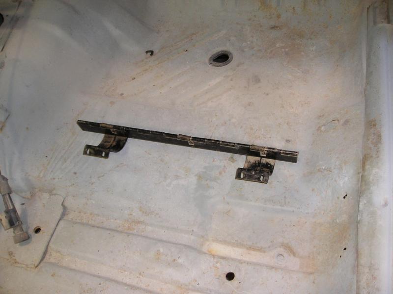

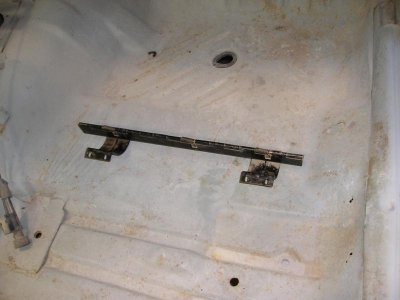

I was just putting one of these in today and took some pictures for you.
It's one of those baffling installs until you see how it goes in and then it's DUH, why didn't I see that.
Here's the hinge oriented on the floor.
Oriented for install
There she be
It goes up over the lip on the dash. The screws pass through the dash and thread into the hinge. :glasses2:

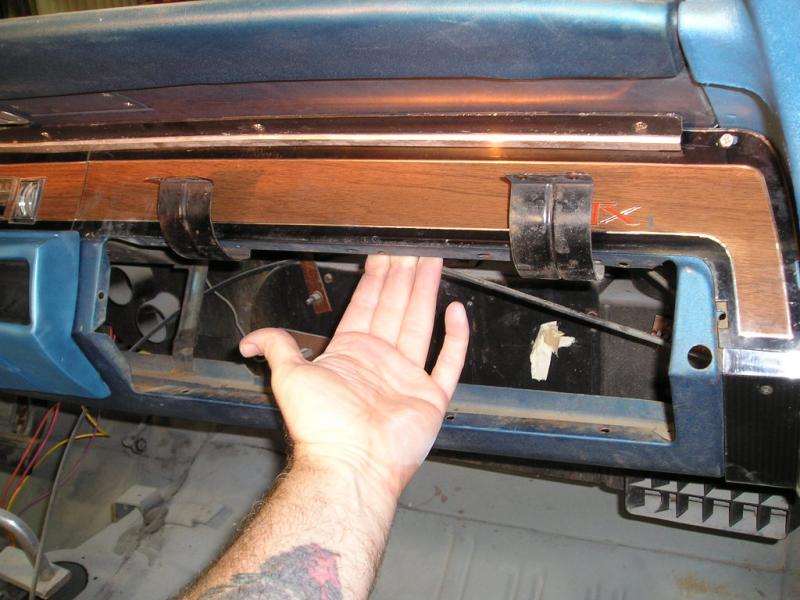

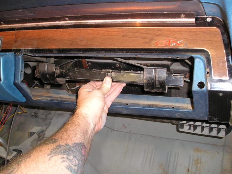

There she be
View attachment 123861 View attachment 123862 View attachment 123863
