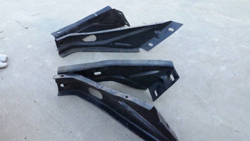

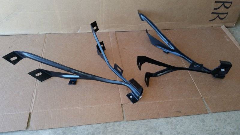

Bob, Here are my front bumper brackets....I cut down my steel oem brackets...they are very light....and no cost to fab
View attachment 683312 View attachment 683313
The second picture shows the front bumper bracket before I cut them down.
This would only work with a fiberglass front bumper

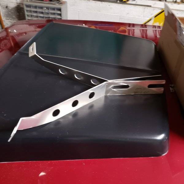

Bumper brackets and aluminum bolts
+ 1.5 lbs.

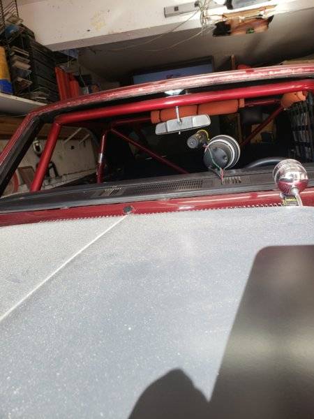

I just removed the rear window and gasket
-24lbs.
Took the deck lid off to weigh it.
-42 lbs.
Grand total of 260lbs. removed!

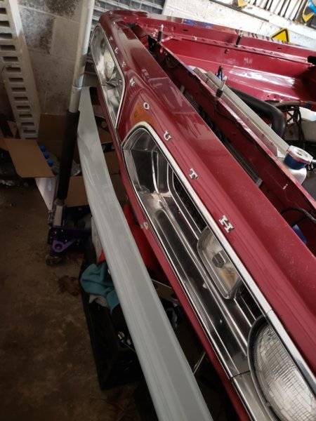

Glass bumper ordered,
Lexan ordered,
Ordering the deck lid next week.
-24lbs.
-42 lbs.
Lexan ordered,

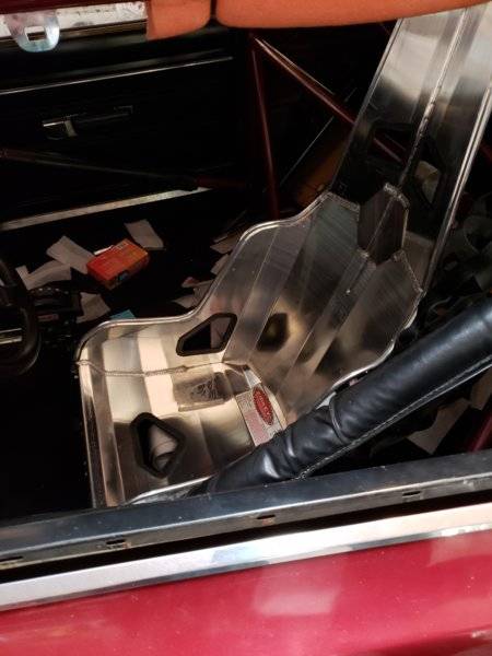

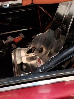

I got some stuff trickling in now.
Bumper brackets and bolts in aluminum, glass bumper and kirkey seat, brackets and padding.
Add 18.5 lbs to the program.
-241 lbs.

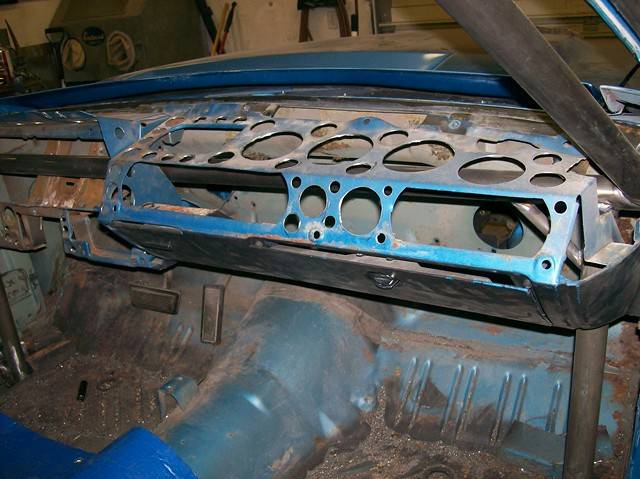

I hole sawed my car where ever possible that is not visible once assembled, added light weight Kirkey seat & brackets, went with aluminum bolts where possible, etc but I refuse to go with Lexan or Fiberglass body parts (so, my car will never be no featherweight). I race with so many buddies & it is such a pain lifting hood off, lifting front clip off or removing door and putting everything back on their cars after every round.
