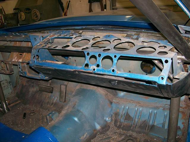

35 lbs. for a stock dash frame and 6 for fiberglass.

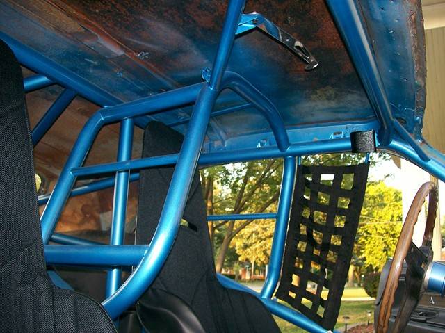

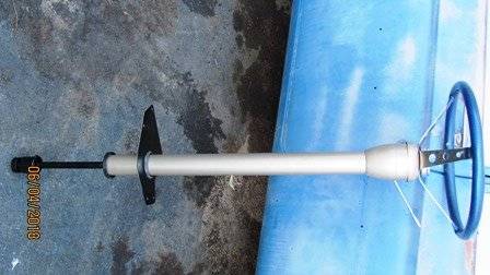

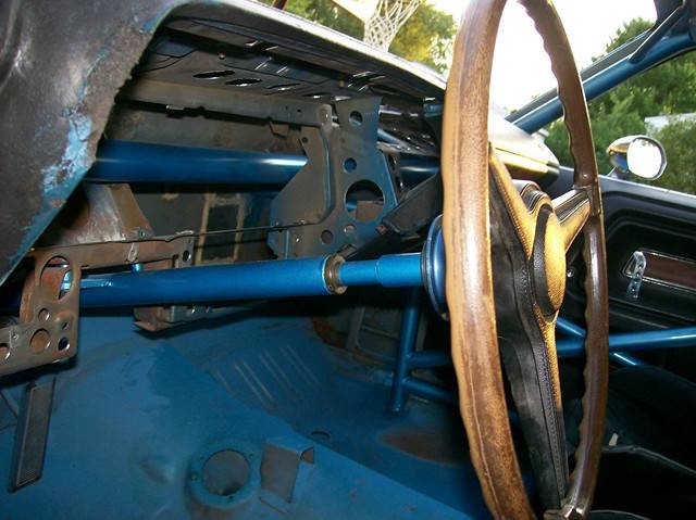

We did make a light weight tubular c.m. column for my car also & I adapted it with the quick release to the stock woodgrain steering wheel for the purists. Still use a stock seat belt buckle for my window net also....

The original factory steering column in my 65 Belvedere (automatic column shift) weighed 26.5 lbs. I kept the turn signal/horn part, used parts from a 64 Dodge, 65 Plymouth, 75 Duster, and some aluminum tubing. The "new" column looks like a factory 65 floor shift column and weighs 10.6 lbs with the added bonus of a collapsible column shaft. Not a bad weight reduction.
The original factory steering column in my 65 Belvedere (automatic column shift) weighed 26.5 lbs. I kept the turn signal/horn part, used parts from a 64 Dodge, 65 Plymouth, 75 Duster, and some aluminum tubing. The "new" column looks like a factory 65 floor shift column and weighs 10.6 lbs with the added bonus of a collapsible column shaft. Not a bad weight reduction.View attachment 690741
I thought there might be a fair ammount and saw that he still had the factory column....Thanks for the numbers, it's better than I thought!!!

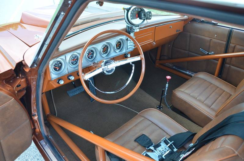

Gutted doors and K frame. Moly tube for cage, steering shaft, steering column, strut rods, fender braces. Home made stock looking light seats. Aluminum motor plate, fuel cell, driveshaft, seat brackets, and radiator. 1/8" side and rear, 1/4" vent windows made from Lexan, no regulators. Light weight Willwood brakes, Carbon fiber bumper brackets. Fiberglass lift off hood. Removed hood hinges, heater, wipers, factory wiring. Scraped every bit of under coating, including the inner 1/4 panels all the way to the door jambs. Stuff that wasn't done and made it heavier; all steel body, floor pans,inner fenders, and bumpers, Stock windshield, 2 full size batteries, truck Dana, production dual late model Challenger fans, full size radiator, Mega block, (heavier than stock), fire system, old school American 200S, full interior and dash (no backseat). As stated above 3115lbs empty. With me and full fuel 3345lbs.
Made it look as stock and period correct as I could.

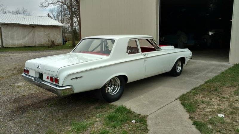

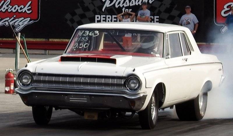

doug mine is at 3383 with me in it race ready. It was a lot of work but well worth it. i like you like the stock look. mine is a little slower than your though. 9.891 at 136and change. but I have a small cid engine .

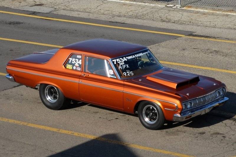

Were doing another N/SS 64 Dodge Polara 500 right now. All glass forward of the doors, Aluminum 572, Lexan side windows, std steel cage, Dana. Motors done and dynoed. Body is on final prime. it'll be interesting to weigh it.
