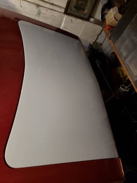

Deck lid showed up today.
+ 20 lbs.
I got a bolt on one so I wouldn't have to deal with pins when fueling up.
I'll post pics in a couple days.

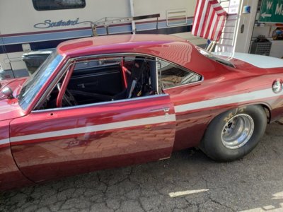

If you're keeping score, I'm down 221 lbs. Over last year.
Just need to install lexan and I'm done for this year.

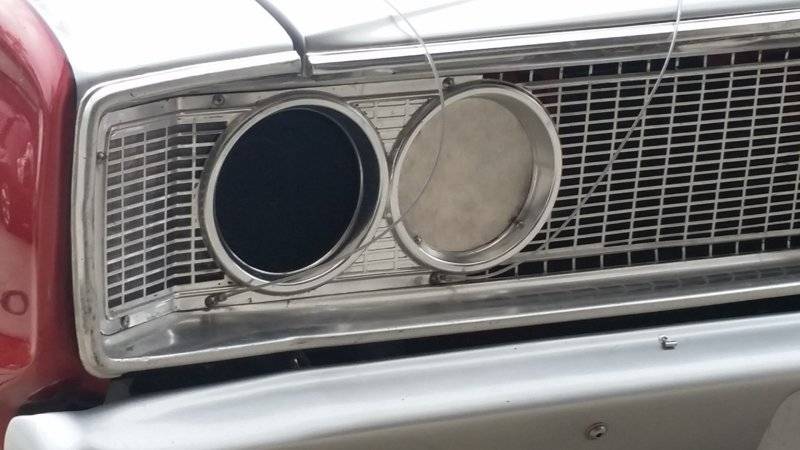

I bought some headlight decals and put them on aluminum pieces to reinstall in the grille. Save a bit.
I did the same thing....except I did only one of the headlites on each side. I put black screening in the outside headlite holder to kinda simulate the old thunderbolt air inducts.
In this picture I had not yet stuck on the headlite decals I got from Summit.
They are on now.

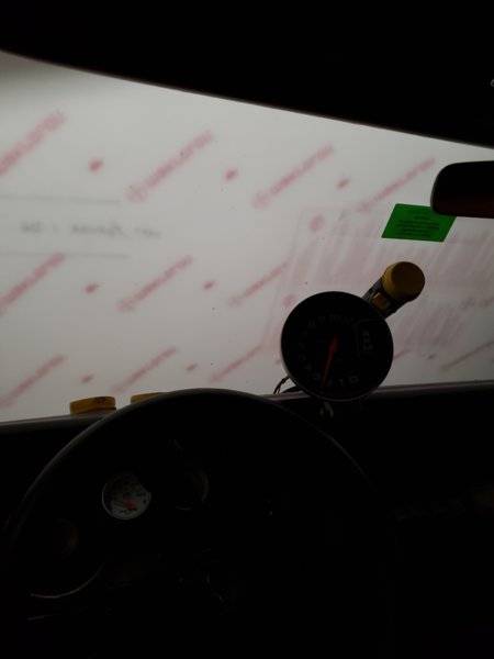

Lexan arrived today.
I'll officially be 190 lbs. Lighter than my last race. I'm going to work on myself for 10 lbs. to make it an even 200.
I'll be looking for a 9.40's time slip in a month!
Shakedown racing in texas.
All precut lexan, pre welded window frames, rubber windshield spacers, all hardware, everything needed and shipped for 800 bucks
What a pain in the ***!
Hopefully it's worth it.

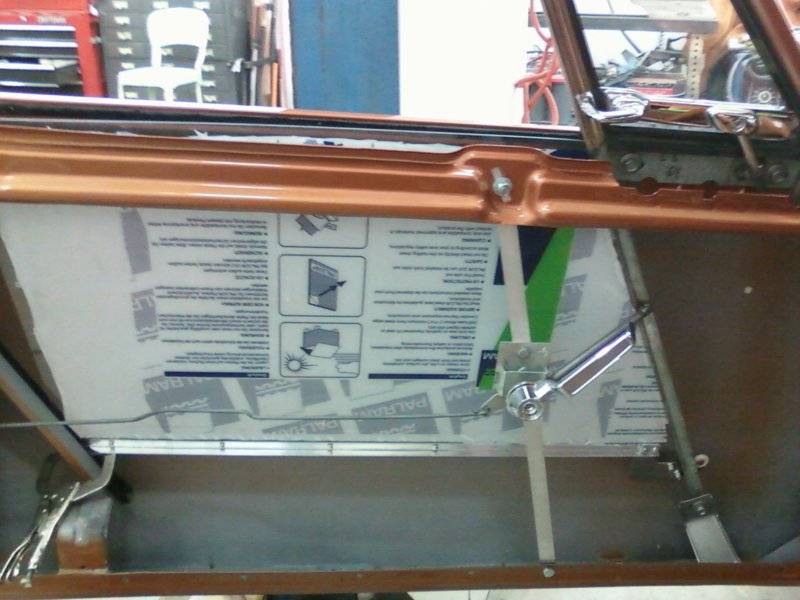

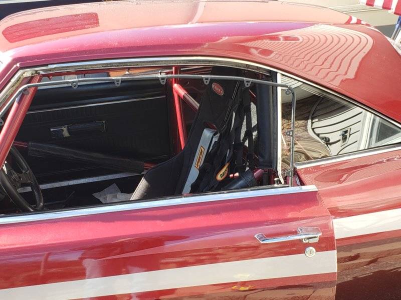

Got the rear window and rear quarter glass installed and mocked up door window frame today.
20190317_151534.jpg 20190317_151529.jpg 20190317_154149.jpg 20190317_154133.jpg
It could be worse. You could be making them go up and down.

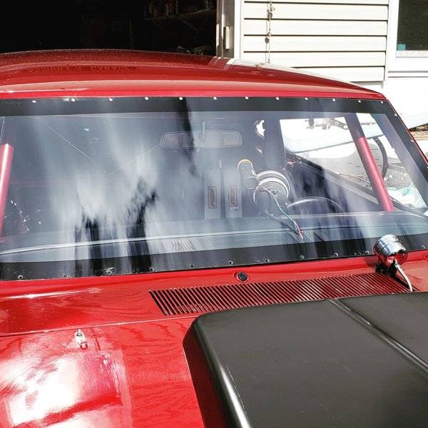

How much weight did you save in the windshield? Mine needs to be replaced was thinking of doing Lexan.
The front windshield weighed 27 lbs.
The gasket was 5 lbs.
The lexan weighed 8 lbs.

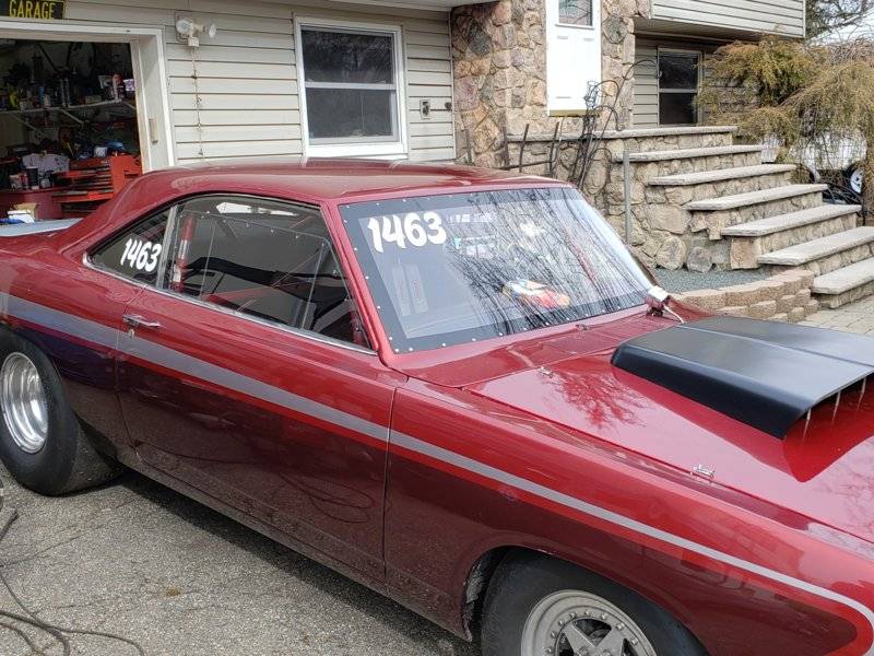

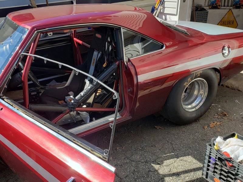

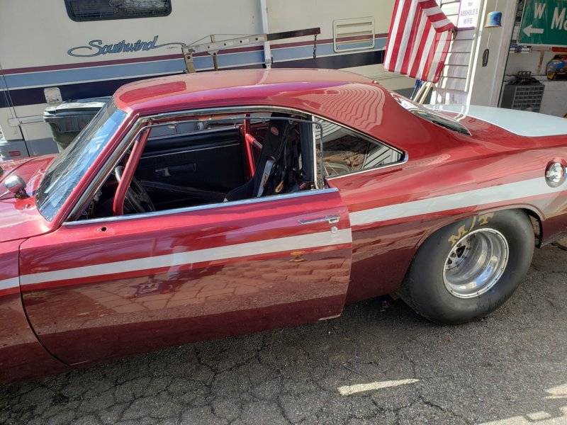

Finished all the lexan install this weekend.
It probably took me a full 8 hours of work to figure out and install the drivers side windows. Once I finished, it only took an hour and a half to do the other side.
I wish I did the passenger side first.
The second one came out much better.

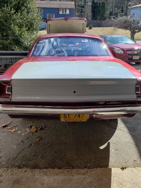

Time to paint the deck lid.
Doug
I just got it to fit on the hinges correctly yesterday.
Latch is giving me problems.
I need some wedge shaped shims to make it work.
