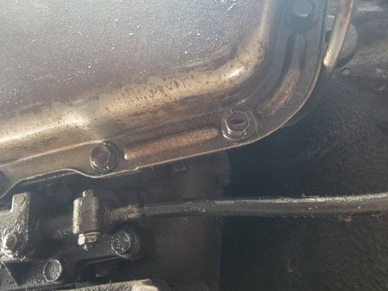

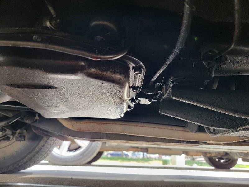

Hi guys like the topic says I'm replacing gasket to my transmission pan, I know those bolts are 150 inch pounds torque... so my questions are the filter what are the torque specs on that and I also have purchased a rubber gasket not cork... do I need to put anything on it to seal better ? Another question is how many quarts will I need to refill ? Just taking pan and filter off... and what is proper way to restart and run transmission after doing this refill..

Quite often the shift selector seal is the cause of leaking fluid.
It seems like the pan is leaking but often its the seal.
What pan are you using? Steel or aluminum?
I am using stock pan I believe, also does anyone know how many quarts I would need to refill ? If I only remove pan and filter ? I see 4 or 6 quarts not sure which one is correct...
