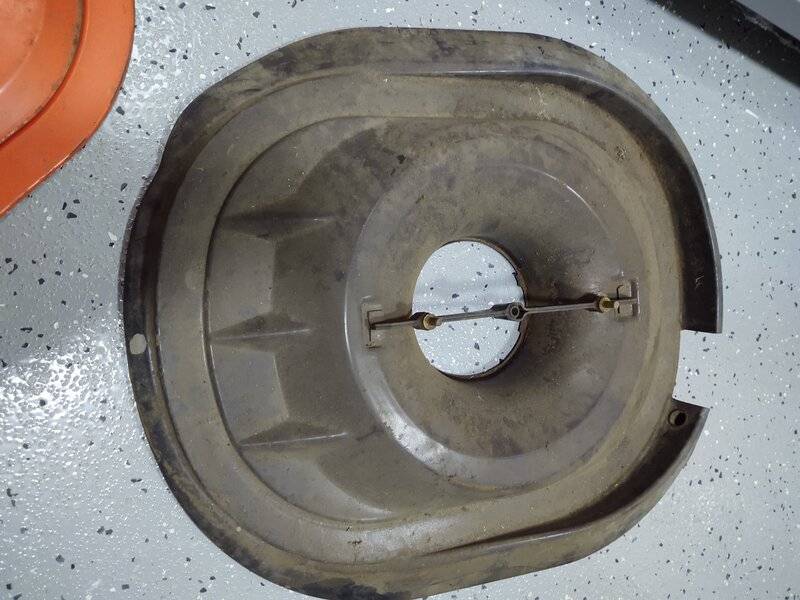

Got this as a gift from my buddy yesterday. I think it's awesome. We've known each other for years, both starting out as sanitation engineers (garbagemen) in 1977. Coincidentally, we both left for long careers as firefighters. However, before my buddy left for "the greatest job in the world", he picked this out of the garbage (35 years ago). He had saved it all those years until I retired.
It's in decent shape, with only a couple dings, with the baseplate being modified a bit (unfortunately). For the heck of it, I measured, and it appears to be from a 383 car. How cool is that - from the trash!

That baseplate was cut to accomodate the 2 speed wiper motor clearance on the car it came off of. All air grabber cars with that plate had 3 speed wipers for that reason. You'll see that quite a bit. Nice score man jealous!

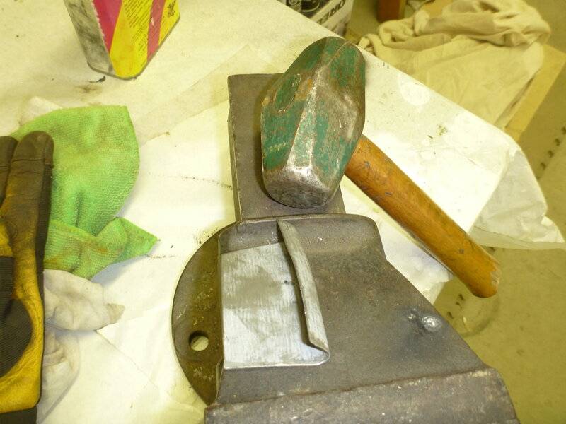

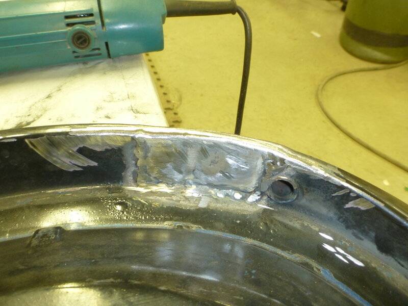

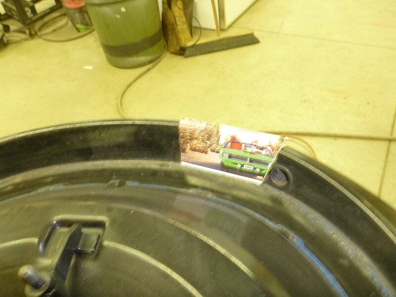

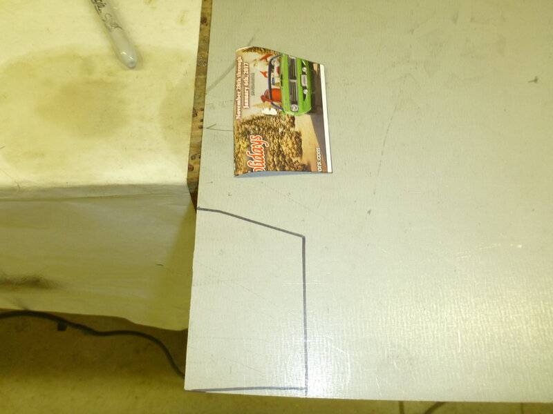

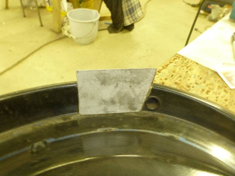

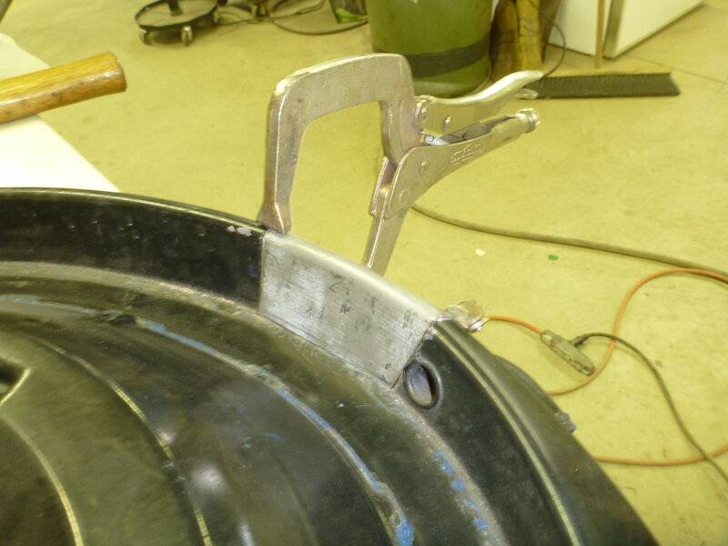

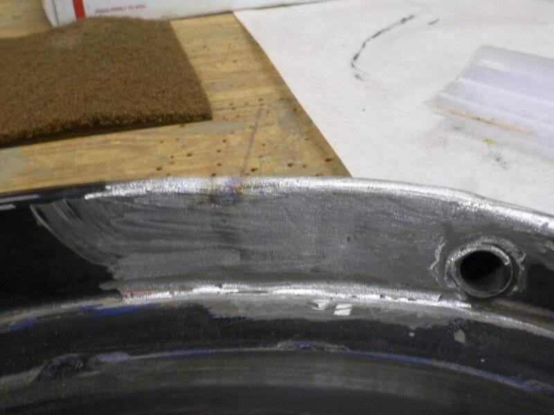

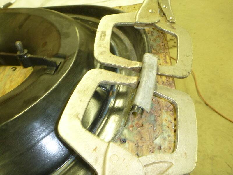

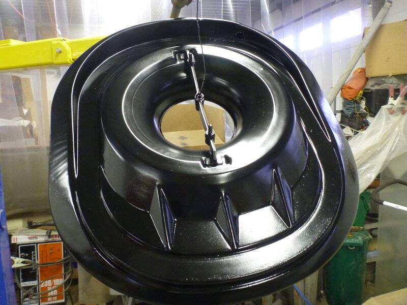

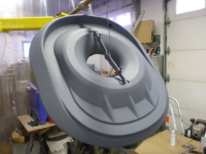

NICE! Not a cheap item. Cut out is an easy fix and somewhere in my resto thread, but here..... just try doing a bit cleaner job than I did! lol

That's what I had thought. Thanks for the info. At least it's a nice clean cut!

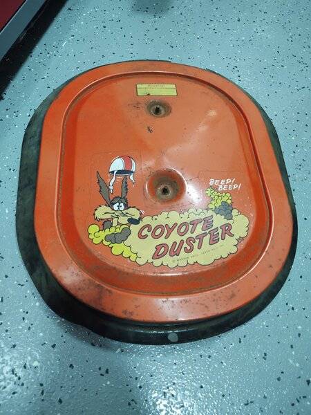

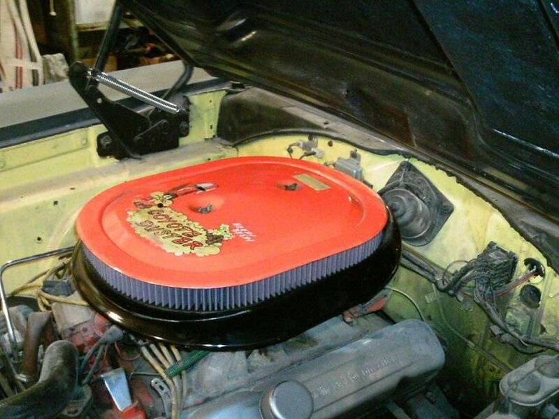

I have one on my car, and it clears the two speed motor just fine.
could be. The vent tube was damaged, so I removed it, and with a little jiggling it fits.
