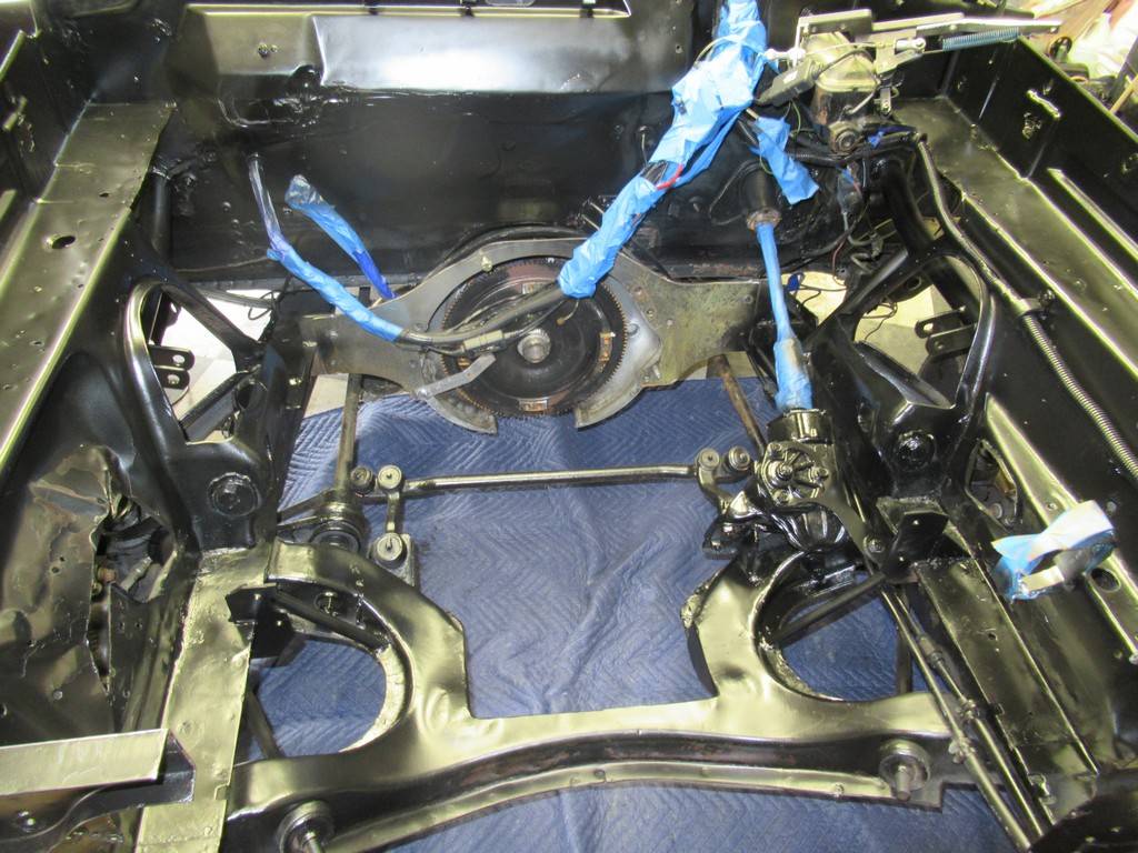

Shooting to be ready for Carlisle. Got to use the DA in the engine compartment and shmear some body sealer.

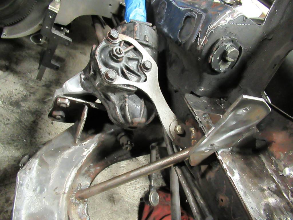

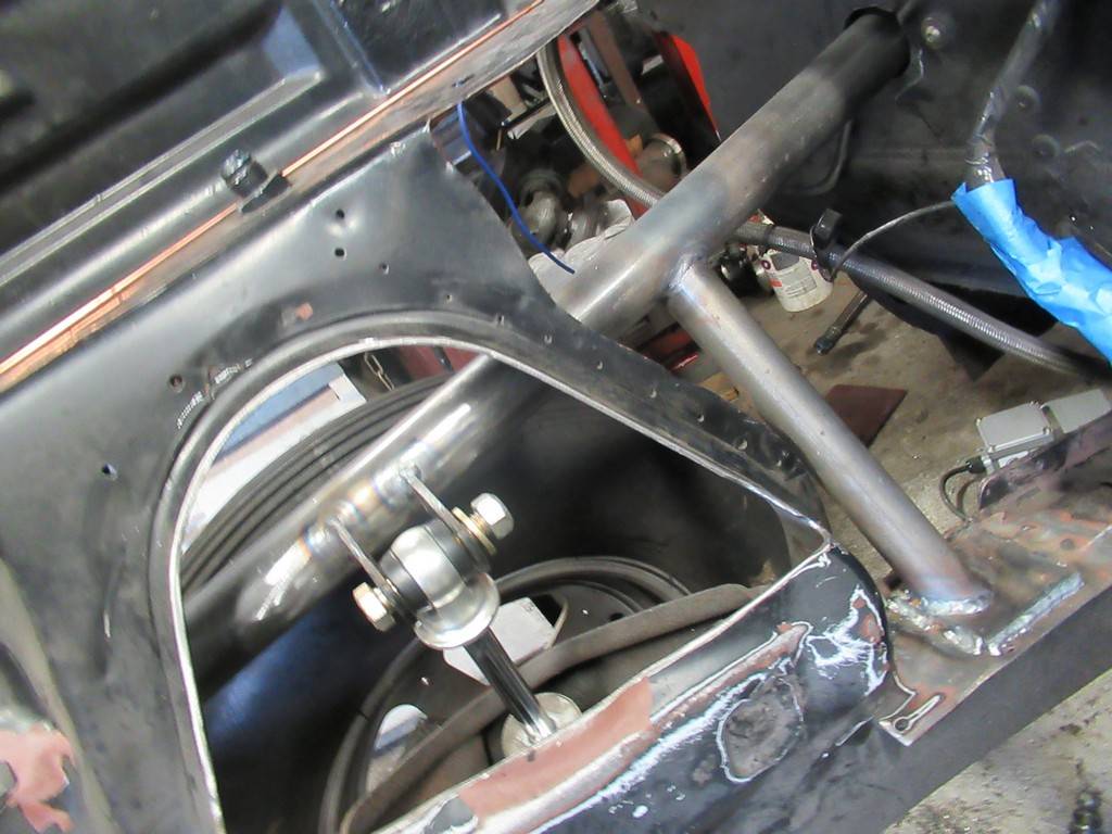

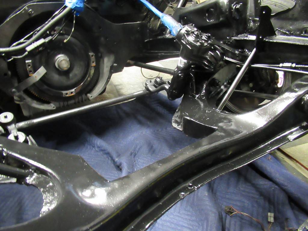

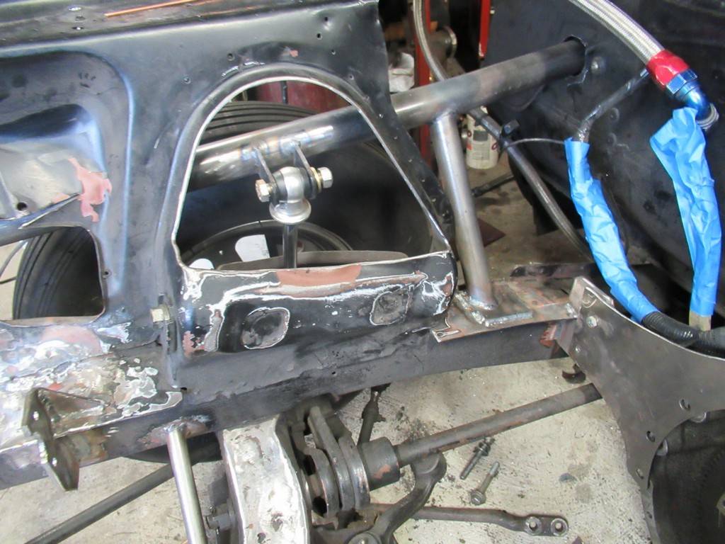

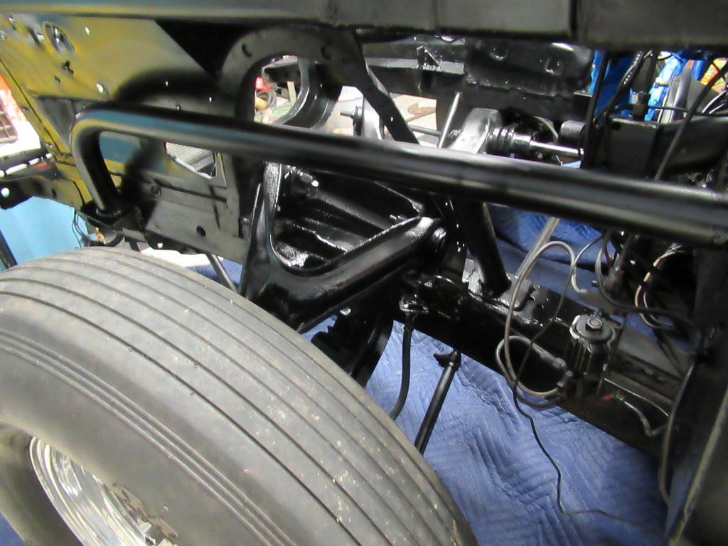

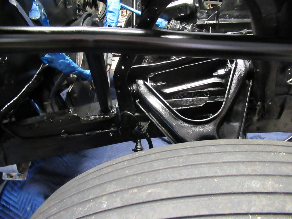

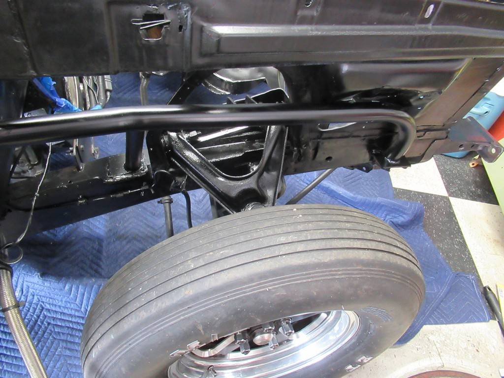

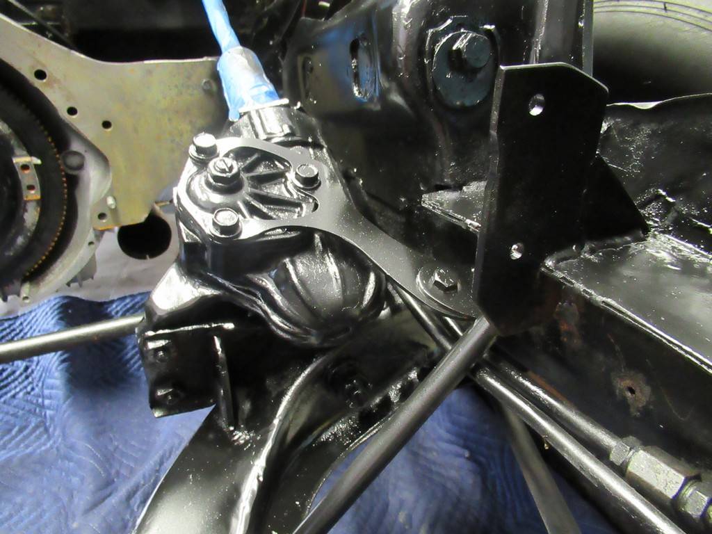

Real happy with the upgrades we did!Car will pick up nicely:D
5.20.17 021.jpg 6.6.17 005.jpg 6.6.17 006.jpg 6.6.17 009.jpg 6.6.17 011.jpg 6.6.17 012.jpg

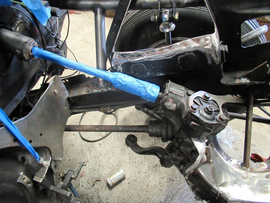

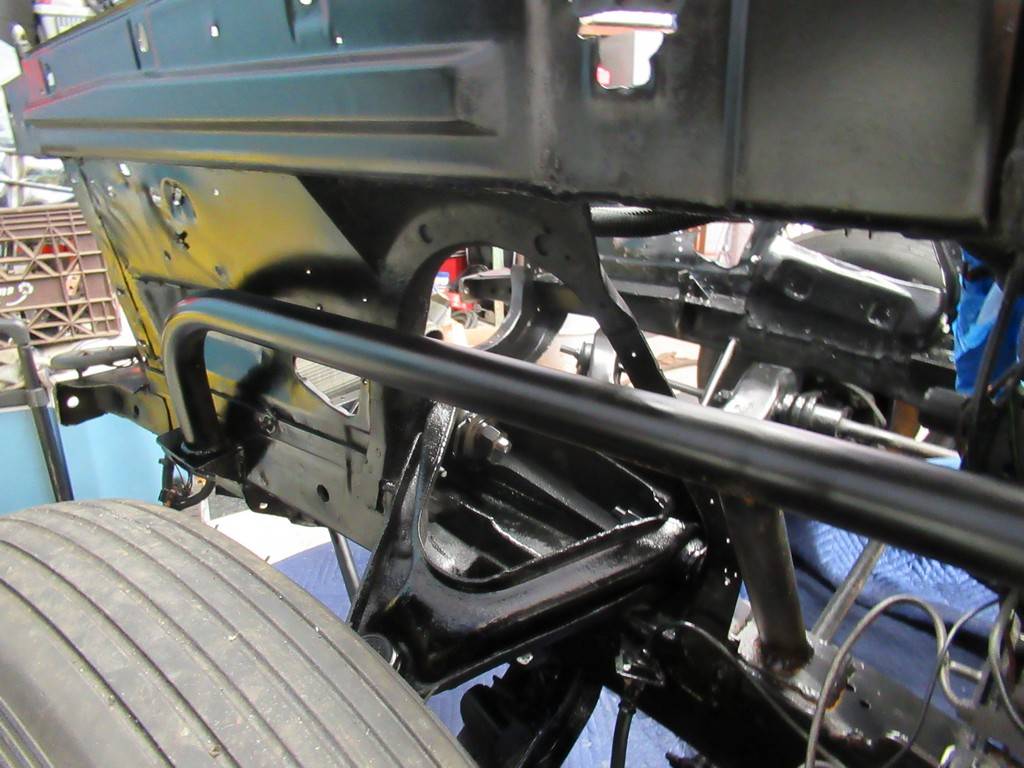

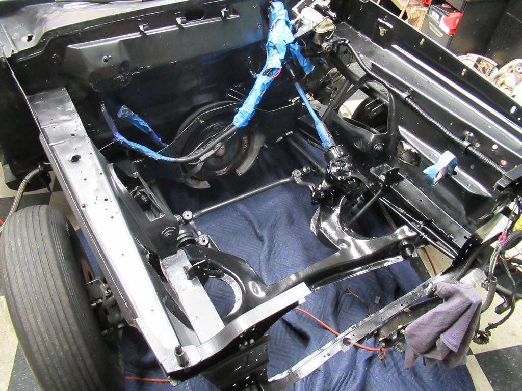

Yeah man, diggin those upgrades. No twist in that front end no mo.
And that steering box brace is pretty slick.

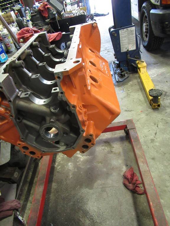

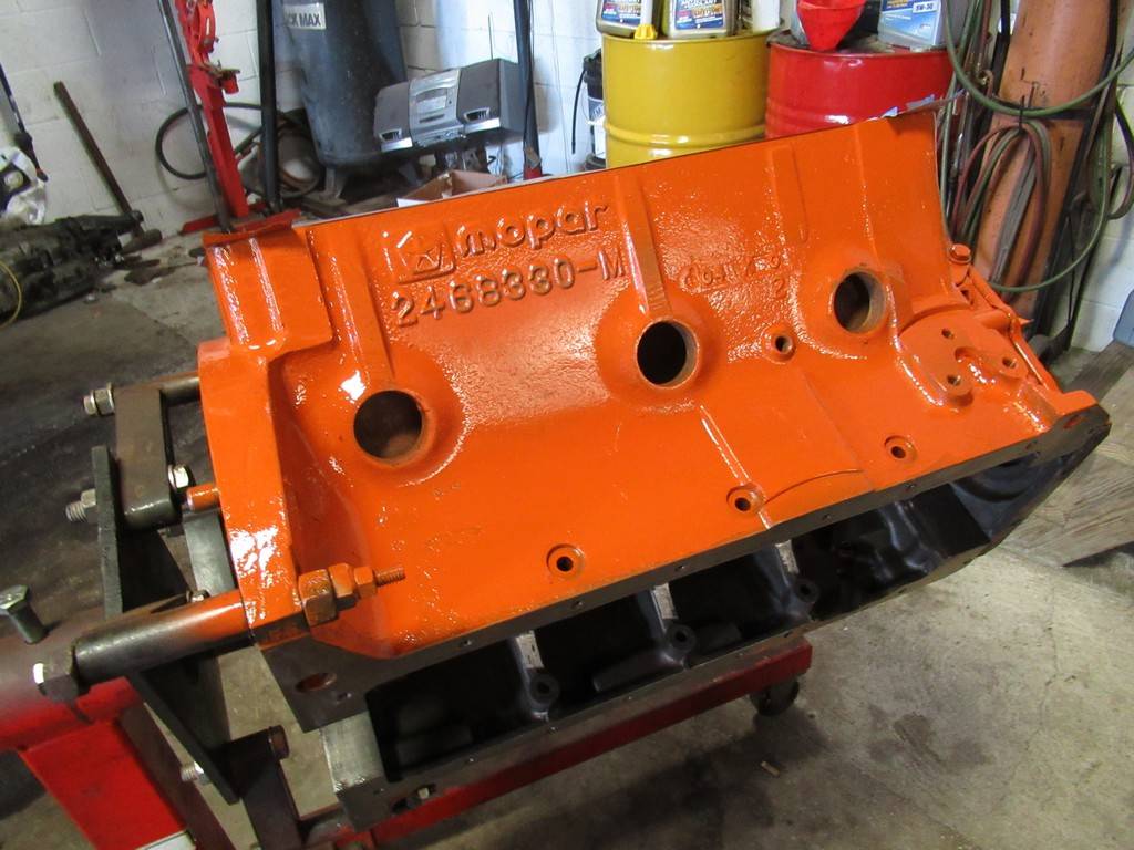

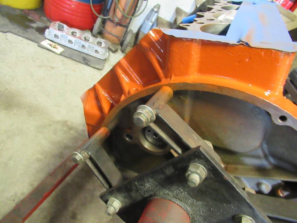

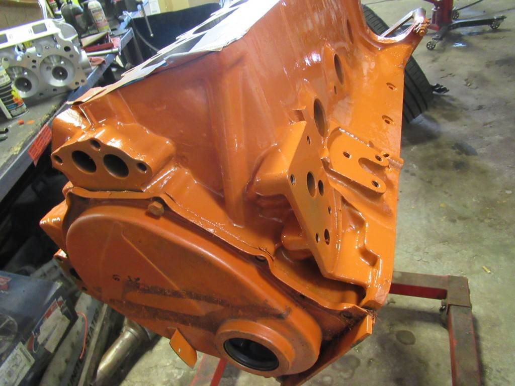

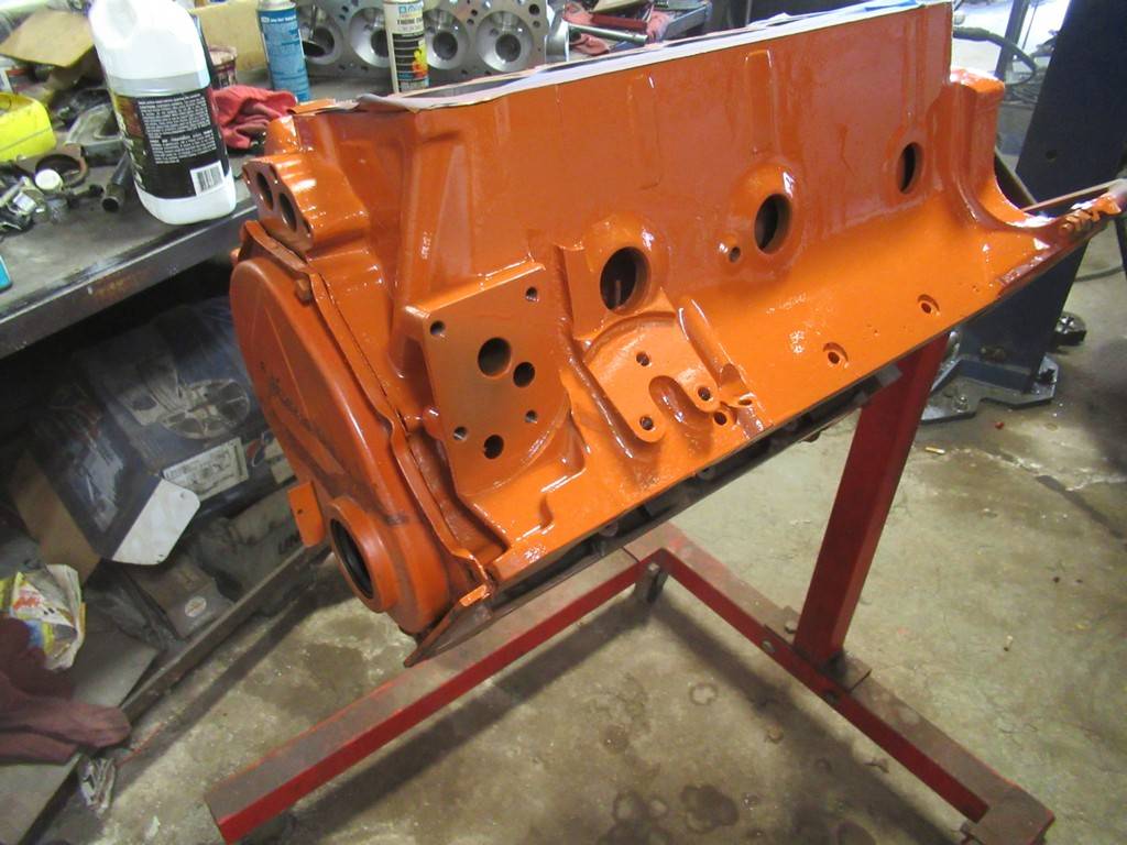

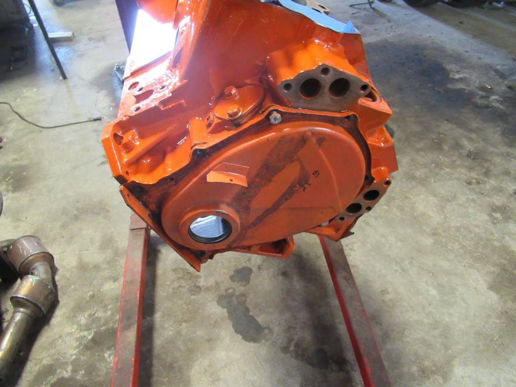

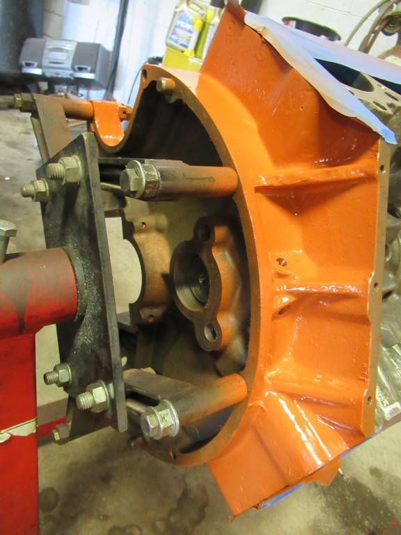

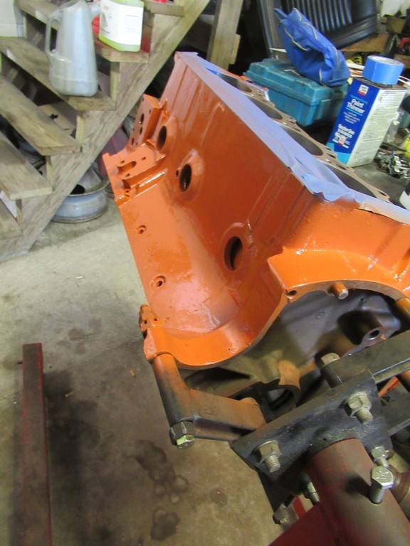

Engine compartment spray bombed,gave the block a new coat today!Hope to get the shortblock assembled this weekend...............
6.22.17 003.jpg 6.22.17 004.jpg 6.22.17 005.jpg 6.22.17 006.jpg 6.22.17 007.jpg 6.22.17 011.jpg 6.22.17 012.jpg 6.22.17 013.jpg 6.22.17 014.jpg 6.22.17 015.jpg

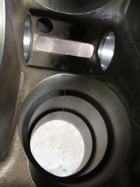

Intake had to go back to the machine shop,the blower mounting surface is not true and the clearcoat they sprayed everything with has to be milled off.

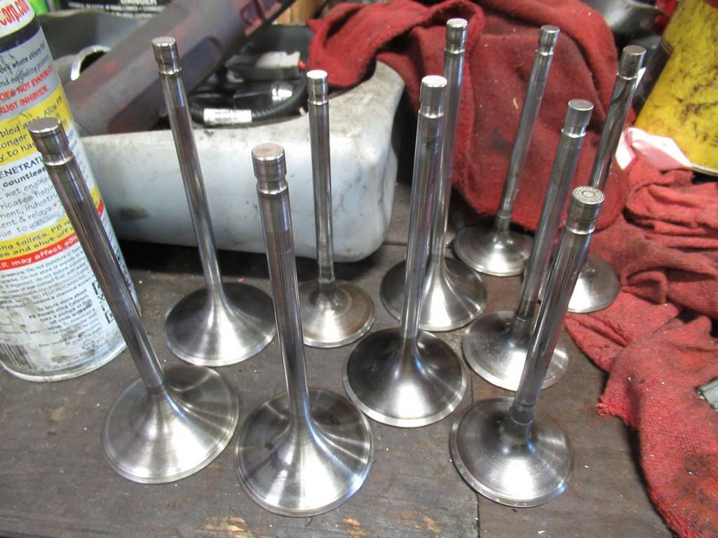

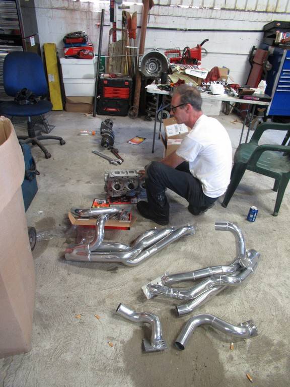

Tried to assemble the heads today,when the machine shop "touched" the seats they made a boo-boo,so back to the machine shop to drop them today.He was very apologetic and will have them ready Wed afternoon.This shop is a 70 mile round trip:BangHead:

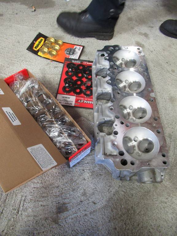

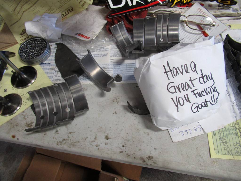

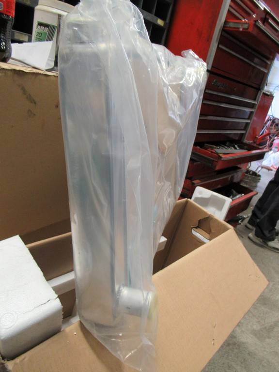

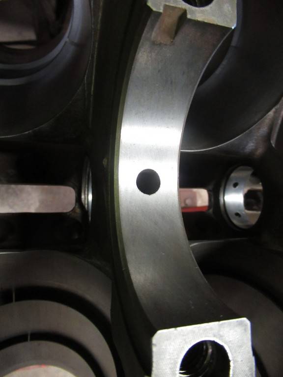

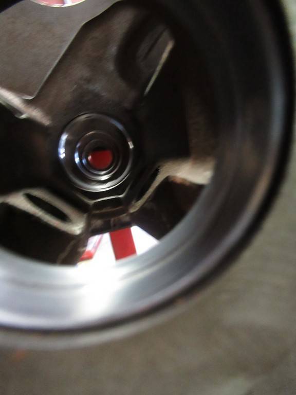

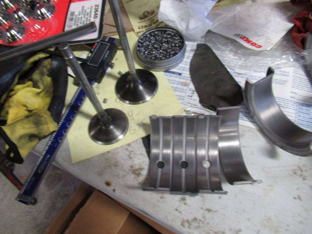

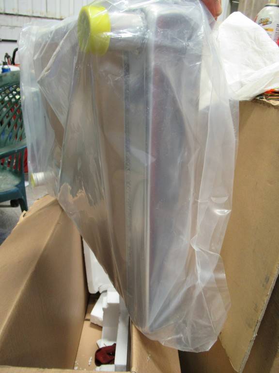

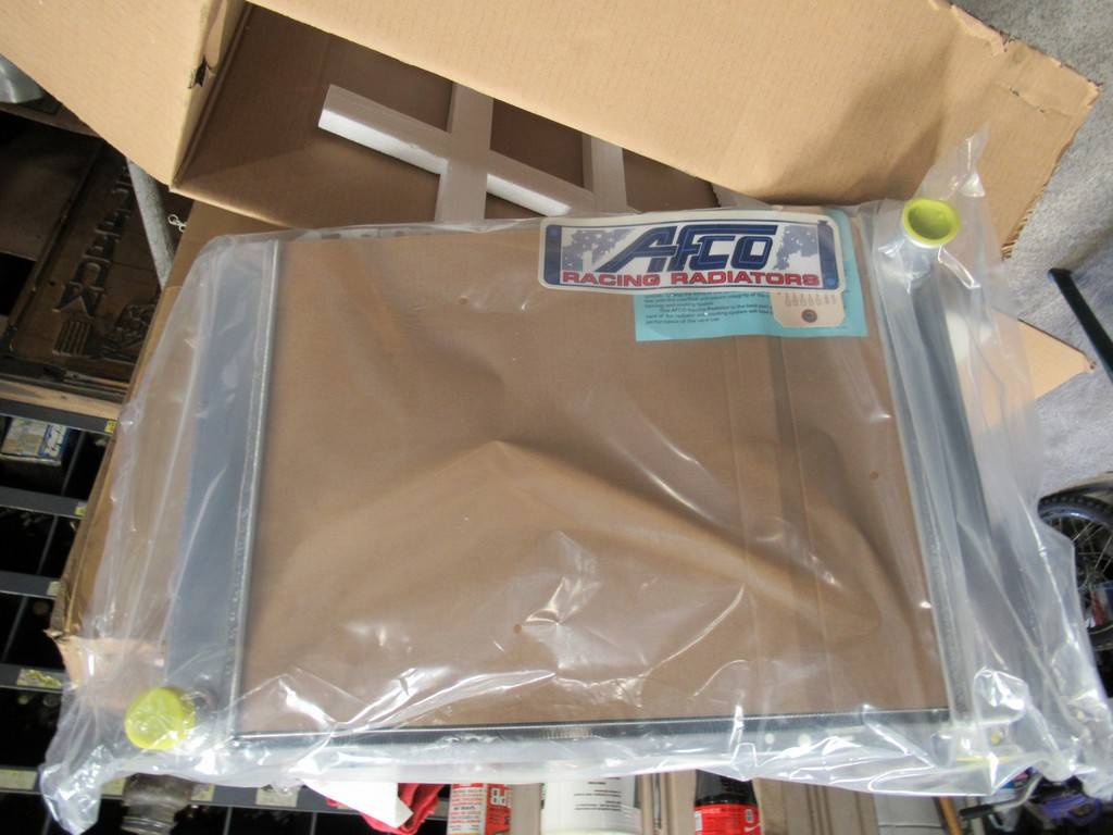

Will pick up the bare heads on wed,so hope to assemble the heads that afternoon,that should take maybe 2 hours.Block is wasc cleaned and cam bearing were installed and the block recleaned.The bearing have all been massaged & prepped and the rings are prepped and in their proper boresSo between Wed & thurs the long block will be assembled..Can drop the engine in on Saturday.After the engine is home,still have fab mounts for the new Afco aluminum radiator and modify the exhaust to accommodate the engine set back.
6.1.17 022.jpg 6.1.17 024.jpg 6.1.17 026.jpg 6.1.17 032.jpg 6.1.17 034.jpg 6.1.17 037.jpg 6.1.17 042.jpg 6.1.17 045.jpg 6.1.17 046.jpg 6.1.17 048.jpg

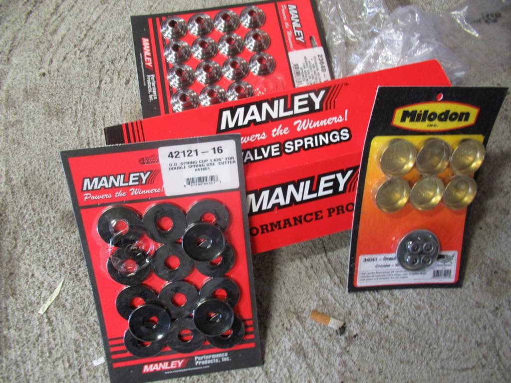

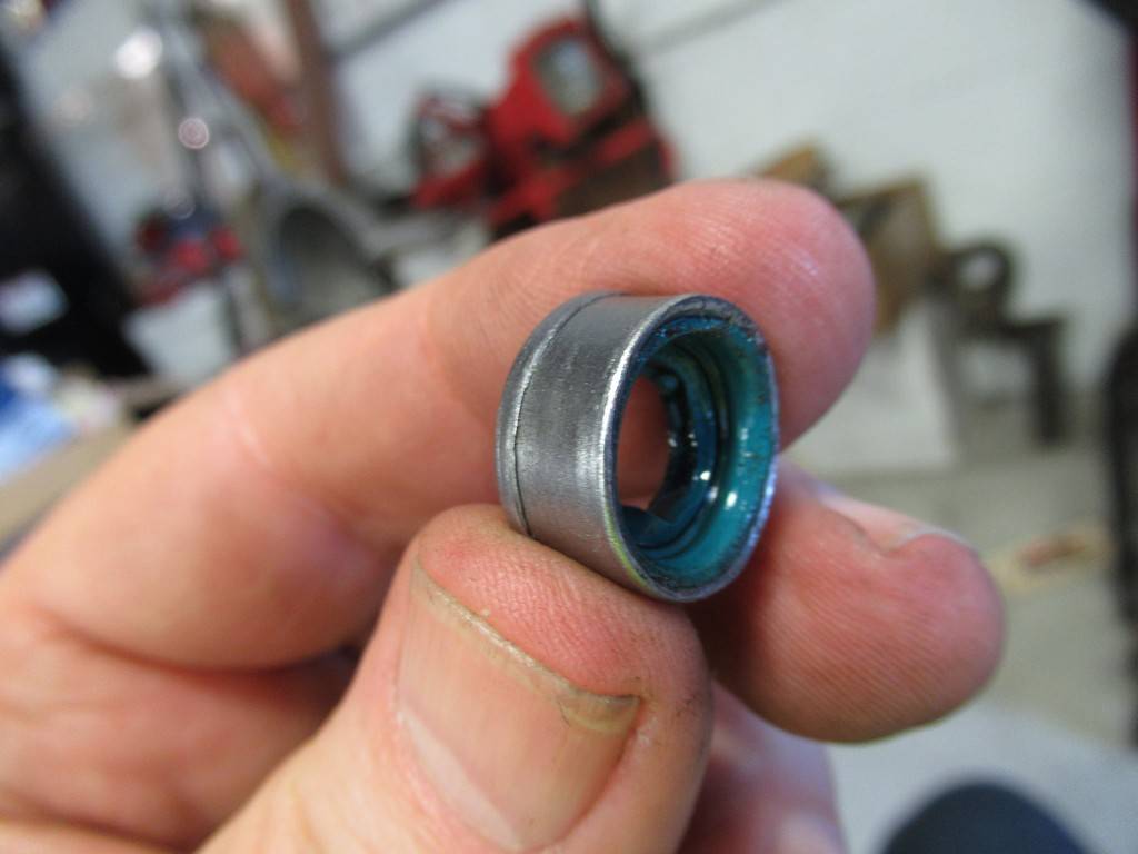

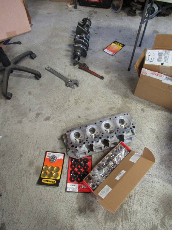

New polished Manley springs,titanium retainers and spring cups came in from http://www.mopartsracing.com/tmc/. Todd is a great guy with ample stock.He had the Milodon bronze freeze plug kit in stock as well as the Milodon crank gear that needed to be replaced.The oil pump drive with the bronze gear was in perfect condition so it will be reinstalled.

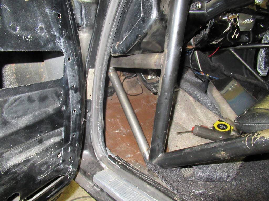

diamond pistons on who's rods ? i'm just doing a wedge @470 b with stage 6 chapman ported mw heads and a matched ported mopar mw intake , i'm going @12.6 scr flattops and a @3.9 stroke . what length rod would you put in the b block ? my car will be driven strip/street , its a 63 sf , here is a pic of her .

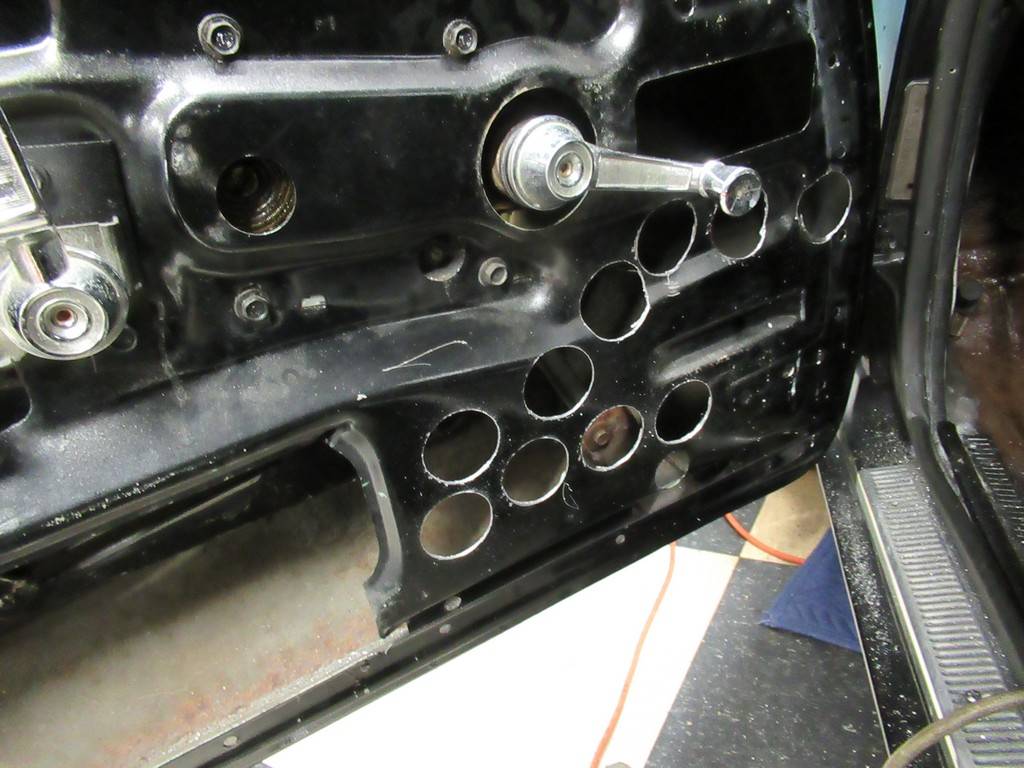

oh ya , i put hot rod door electric window lifts in , there way lighter then that factory stuff . and i will be returning to a full cage and supports to the front of the frame rails . i like yours by the way . this car has had the front inner fender wells steel cut out and replaced with alum sheet . car was trimmed for class back in the 60's-70's . but on the track and street she twists the nose .
