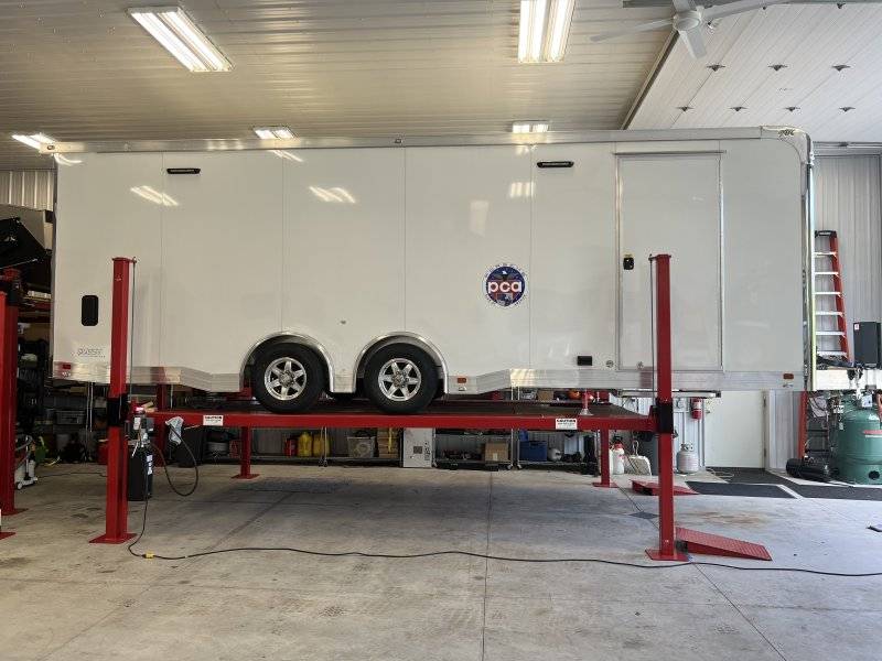

Got the Classic Backyard Buddy 4 post lift installed today...

I got a 4 post lift in September. I must admit they make working on a car easier. Right now, I have a car up on the lift, another below it and it freed up a bay for doing the body work on a third car. I should have gotten one 20 years ago.
Terry W.
In total I have 6 BYB lifts, 4 of them are the trailer model. I use 2 for working, the others are for storage. Great units.
Those are nice. I’m going to order 2 for storage for my 15’ ceilings as they are not worth a crap for working under.

No specification on concrete psi, the feet are not anchored - it's a free standing lift with large feet plate. 108" x 167.5" from outside plate foot to outside plate foot. There is a detailed drawing here, just scroll through the pics:

That being said Snook. Could one fella move it around do you think? You don't have the wheel kit??
It has the wheel kit (casters) was included. A child could move it around. Not designed to be moved with a car on it though. Nice setup and comes with the lift.

Thanks Snook! Appreciate the info on moving the lift around. Good to know. With my 8' 10'' ceilings, it's really only choice I have. I also would raise my rafters up where the hoist would call home to give me higher range. Be a lot easier than tearing the floor up and putting is some footings for a "normal lift"
