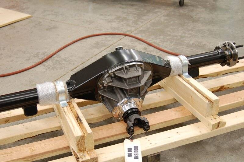

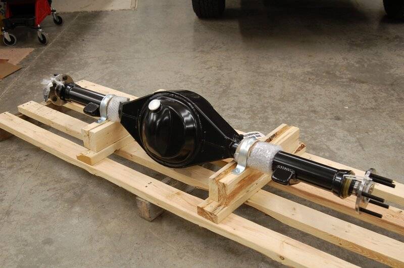

My new 9 inch assembly showed up the other day. It is a full Strange Engineering unit ordered from Doctor Diff. I went with the Pro nodular iron case with polished gears (3.89 ratio) S trac differential, bigger pinion support, billet 1350 yoke, fabricated housing, boxed mounts for the leaf springs, etc. I have 13 inch Baer brakes to install and then it will be ready to go under the car. This is the third rear end I've bought from Doctor Diff over the years and they always show up ready to go.
Andy, do you get to specify the pinion angle ?
Yes, the assembly is custom built so you specify everything. Width, axle offset, bolt pattern, location and angle of pads, pinion offset, etc. Plus you have to pick all the parts. I upgraded most of the parts since I'm running a 512 inch low deck and didn't want to break anything.

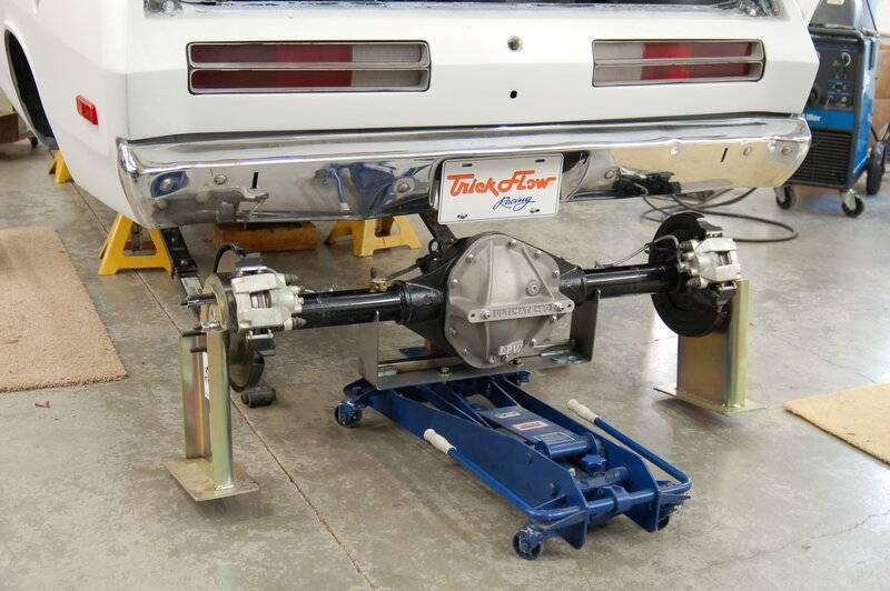

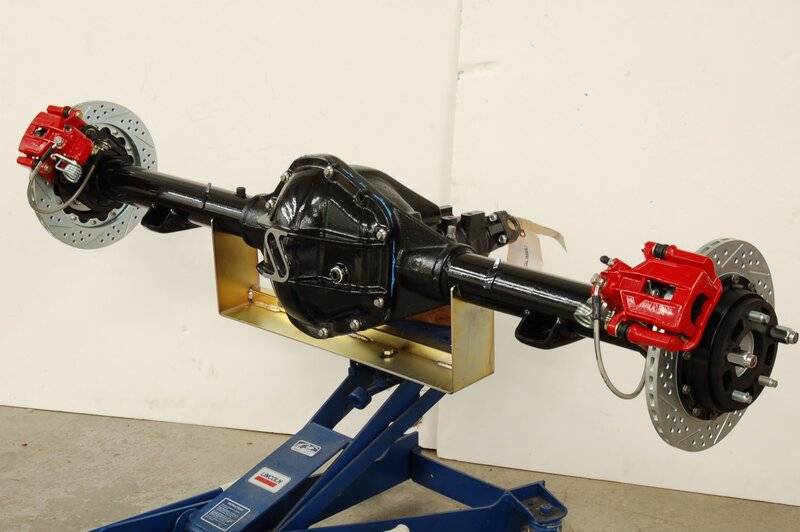

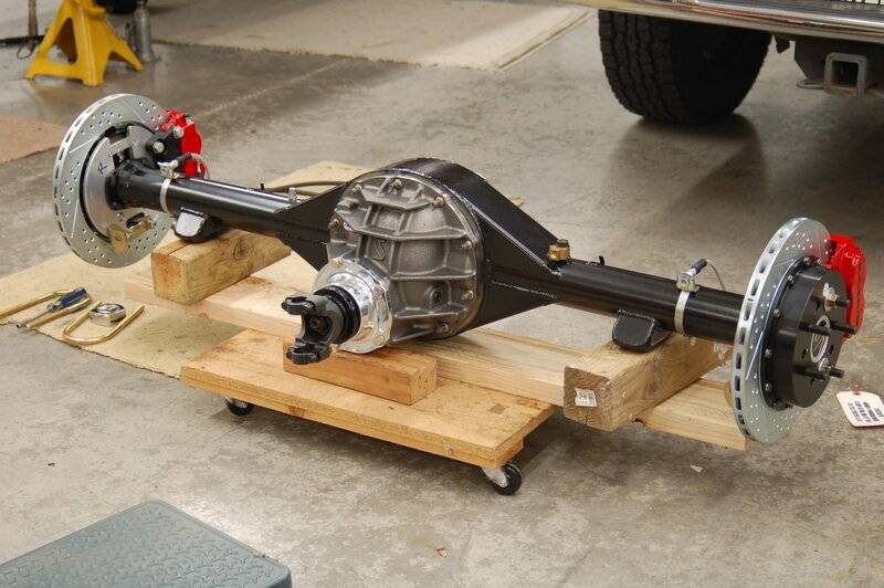

I got the Baer brake kit installed and then weighed the full assembly. It is 212 lbs dry so it will end up right at 220 lbs once I add a gallon of gear oil. I need to weigh the S60 after I pull it out from under the car before I'll know the difference. I'm assuming that the 9 inch is lighter but I don't know by how much. I will need a new driveshaft though. The 9 inch is about 3 inches shorter than the S60.
I'm sure we are all curious about the weight difference. ( i will bet it's a lot less than most think. I bet it's not more than twenty pounds.)
Edit: also curious how well the true track holds up.
The difference in drag or lost hp/ torque is what I’d be interested in. The 9” has a pocket bearing and smaller pinion diameter and bearings if I’m not mistaken. Hot Rod or one of those mags did a big study on them and the 8&3/4 is the disrespected slugger and the Dana is the knock out punch.. Best of luck keep us posted .
No difference in drag when rotating by hand. The 9 inch takes about 35 inch-lbs to rotate with the brakes installed. Roughly the same amount of rotating torque that the S60 takes. Maybe it is different when loaded but I'm not set up to measure that. I'm not really worried, I've worked on a lot of fast cars with this same basic 9 inch setup.
