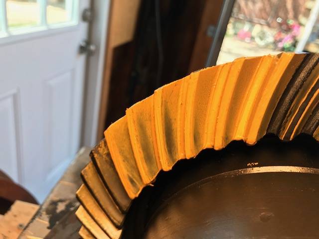

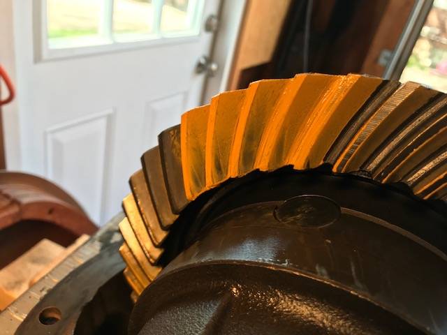

here are a couple pics.
What do you guys think??

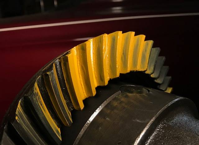

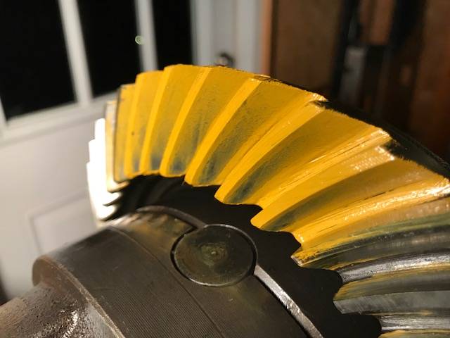

Put your hand on the carrier for some drag as you turn the yoke, then post those pics. This will help you/us see the pattern better and gives a more realistic picture.
PS, rotate the yoke at least 5-6 times.

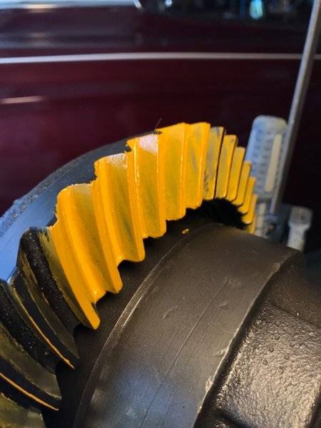

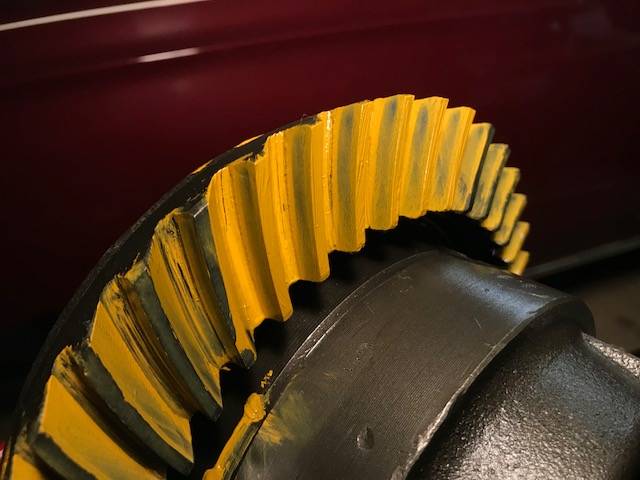

Ok, I was wondering why I couldn't tell much, thanks 5.7 hemi! After new application of compound, providing some drag, and rotating 6 times each direction.
Now, what do you think?
Spread the marking compound at 180* from what you have now. Then repeat the drag/rotation and post up what you get on both sets. You do this to confirm that the pattern is good all around, kinda like checking backlash at 4 spots 90* from one another.
So far I’m liking what I see.
