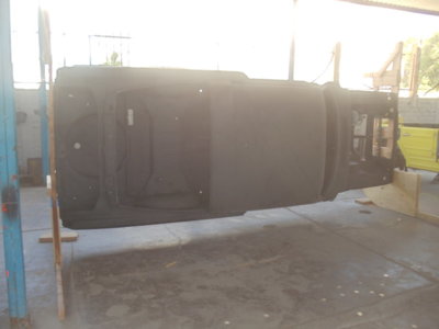

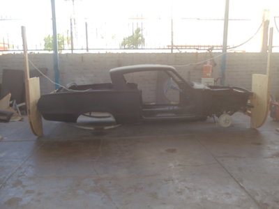

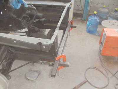

Rolled our '65 Formula S Barracuda over for the first time this morning.
The "home made" rotisserie should also fit the '65 Valiant Signet convertible perfectly we have as well (but I imagine the convertible would need some mid-body reinforcing first).

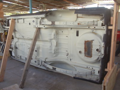

I also used mine once the body was mounted. I then flipped it over and removed the k-frame, front suspension and rear suspension using my cherry picker and lifted everything off from the top. Never had to lay on the ground and do it from underneath while laying on my back and didn't get rust and dirt in my eyes either.
This rotisserie was sold in Canada back in the 80's.
Mounts to the wheel hubs. One man can flip the car using a cherry picker.
I used it on my runner as my shop ceiling height is only 8ft.
