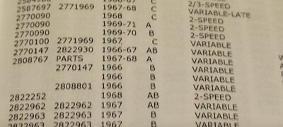

On the page showing part numbers for windshield wiper motors, the second column from the left is labeled “STAMP #”. Some rows in that column read “PARTS”. Can someone tell me what that indicates?

That casting number came from the parts department? Just spit balling.
Mopar parts number first then the Prestolite number is stamped on the steel part usually.
7 digit is mopar 4 is prestolite

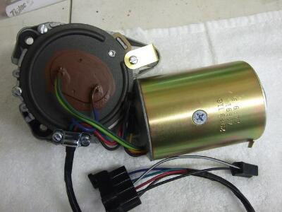

0001454_chrysler-c-body-3-speed-windshield-wiper-motor-3431780-1974-1975-1976-1977.jpg
Only reason I know that is I have the prestolite books and looked mine up to see which knoch I needed to park it properly.
Wait that looks like the replacement numbers mike.
Weird, Would think it is manufactrers, Maybe what is actually stamped on the motor in the XXXXXXX number? No idea then.

I have wondered about that myself. My motor has 2580915 stamped in, which is the part number. Below that is 73691, which I assumed was a vendor number. The date code is below that.
Here is the motor for my 68 RT. The numbers stamped seem to be no different than any other wiper motor. This motor has the “PARTS” designation in the book.
Something a bit strange about this motor is that it is for a 68 B body only. But a 3004114 can be used on a 68 B body or 68 A body. This part number does not show up in the Chrysler muscle car parts interchange manual either.
That 73691 I am positive is the prestolite number. Usually 4 digits and a letter or five digits.
