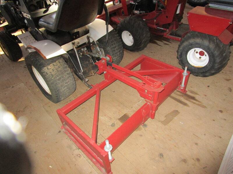

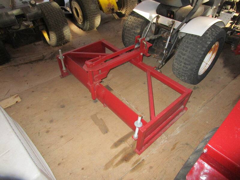

Home made box blade I made using an old drag blade. Drag blade came with a garden tractor set, I bought, worked, ok, but left lines. Wanted a class 2 box blade for the 80 hp, just have not found what I want, for what I want to pay, so, I built a, 0 class unit for the garden tractor. Have not gotten around to adding a scarifier as of yet, use a loaded harrow for now. Added a adjustable up and down, feature to the blade, I can raise the blade, so as to apply new material to the lane way.
View attachment 1055321 View attachment 1055324

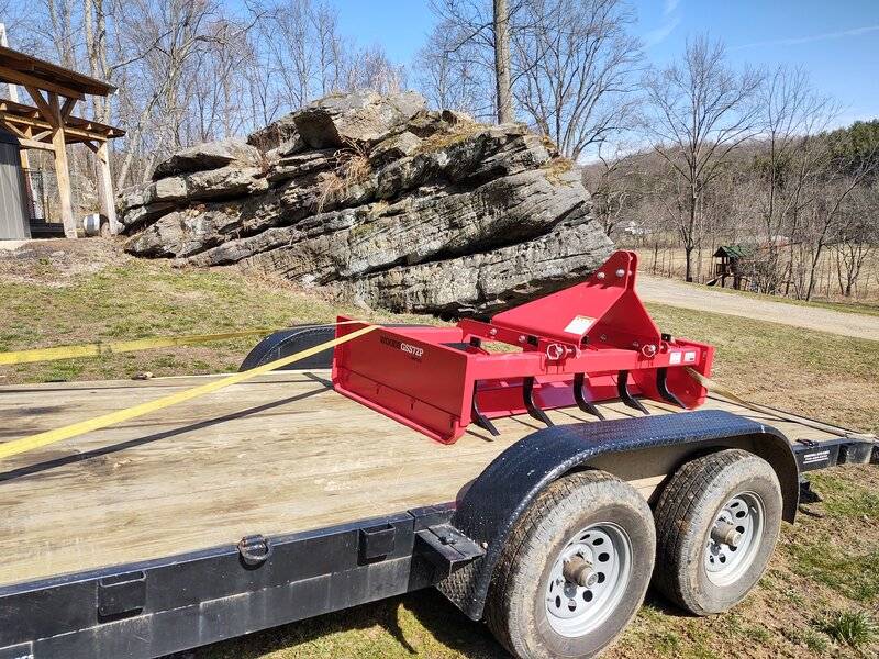

With beautiful weather finally here I took the advice given and picked this up today. I'll let you know how it does once I get the carburetor rebuilt on the old Massey.
I figured I'd come back to this thread and give an update... YOU GUYS WEREN'T SHITTEN! This thing works wonders, first time using it I dropped the teeth to full depth and chewed the driveway up busting all of the potholes apart then finished it off with the teeth retracted. That was in March, there still hasn't been a single pothole that came back! With the potholes gone I occasionally go out after a hard rain to smooth it back out, it's effortless. No need to play with the 3 point to control the depth of cut, once you have the runners set to the right depth you just go!

With beautiful weather finally here I took the advice given and picked this up today. I'll let you know how it does once I get the carburetor rebuilt on the old Massey.View attachment 1083116

This isn't a box blade, it's a land plane.. it works much like a hand planer for wood. It has 2 cutting blades that are laid back at more of a cutting angle than a scraping angle then has adjustable skids on the side for adjusting the cut depth. It won't drag large amounts around like a box will because the gravel rolls right over the blades but I can't imagine anything behind easier to use or doing a much better job on driveways. I'm thinking about adding a removable plate to the backside so I can move gravel after a good wash out?
I'd have to measure my tractor but according to the web it's 72" wide and 43.95 hp? I'm using a 6' blade.

It's a Woods and cost $1,600, I'm sure you can pick them up cheaper but I try to support my local Massey dealer.
I was originally going to buy a box until the guys here convinced me, I can still see plenty of areas where a box would be beneficial but man does this make driveways an easy job. It's a lazy man's tool, drop and go.
