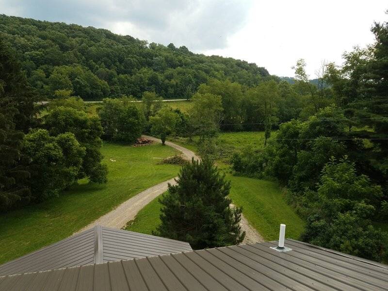

Mine is quite long as well, if you look hard enough you can see the road over on the far hill. We chip and sealed it a few years ago, what a waste of money, lasted one year and it was shot.
