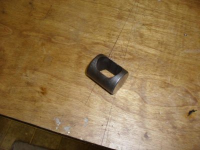

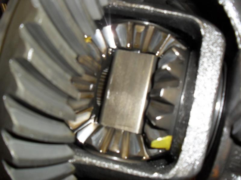

67B-body is absolutely right about having to take the axle spacer out but only if using a 65 or newer center section, the spacer on a 64 and older center section is 1.25 inches long and can be left in place as was in my case. Spacers on 65 and newer rears are 1.5 inches. Easy to identify old one is a square spacer. hope pictures help. SAM_2769.jpgSAM_2770.jpg

I have a 23 spline Dana 60 out of a 68 coronet. I am switching to green bearings. To remove my thrust spacer, do I need to remove the rear section? Or can I get it out with a magnet like I read somewhere else?
I have looked down the axle tube, but I don't see anything resembling any images I have seen. I just see the opposite side axle, which I haven't removed.
