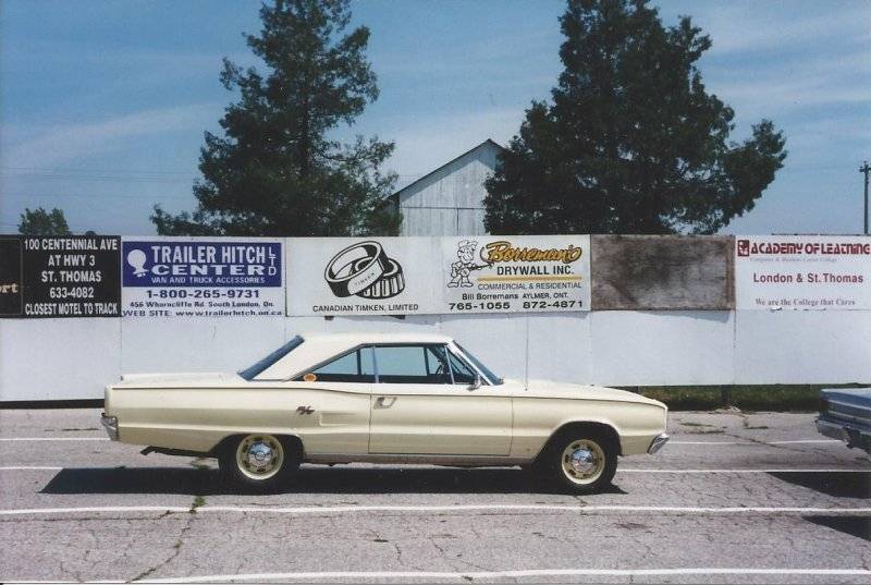

Clear glass was standard equipment on all cars. A lot of times, factory A/C cars got green tinted glass on all windows. This was also a separate option on non-A/C cars. Another option on non-A/C cars was a tinted windshield only. The green tinted glass reduced glare, and was thought to keep the interior cooler. Plus, it just looks cool! I really like the looks of my yellow R/T with the green tinted glass.
