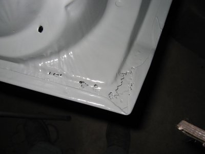

Had to travel out of town on business last week, so not much progress. Before I left, I started to seam seal around the one of the doors. I was in a hurry and didn't allow the wax/grease remover to evap before I applied the seam sealer. It was an old tube of Evercoat 2-part self leveling sealer that I had already used to seam seal the deck lid. Well, for some reason, the clear part came out for a while, then the blue part came out. It ended up being a sticky, gooey mess. I ended up having to break out the die grinder w/ a roll-lok to get it all cleaned off. Then re-shot DP40 over the door edges. I hate it when you try to make forward progress, only to lose ground!

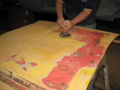

I got bored of watching car stuff on TV and got started on doing filler work on the roadrunner, under the carport, while it rained & rained.
