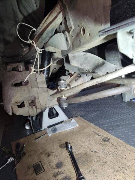

Caliper is hanging up somehow. Look at the slider areas for burrs, wear, lack of lube etc.
When I pulled out the pins, there was no lube to speak of. The car hasn't been driven in over 20 years, mind you. :lol: I gave the shafts a polish with 400-grit and will get some proper lube on them when the rotors go back on.

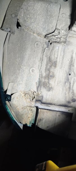

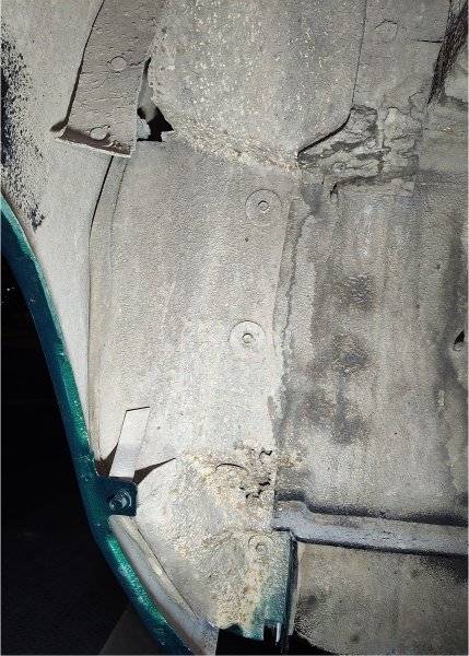

Surprise, surprise...more rust found.
While I had the front wheels off to replace the rotors, gazing up into the fender well, I saw some rust-through on the passenger side splash shield, at the top outer corner and near the bottom. What is that upside-down U-shaped rubber thingy called? Fortunately the driver side is good, I'll just need to replace one splash shield, but both rubber things need to be replaced.
Installation question: It looks like this part mostly just pops in with push-pins, but what's the process to replace it? Is there welding involved?
The rubber is the upper seal of the splash shield and the clips just hold the the rubber to the sheild

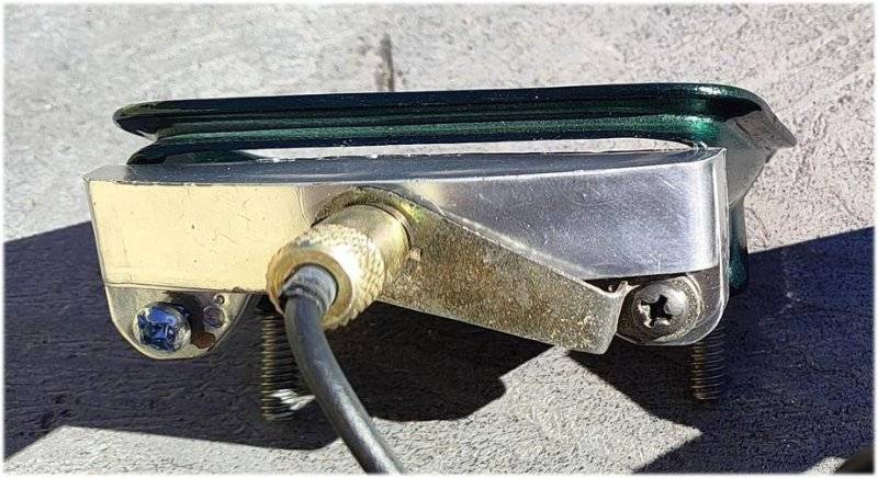

It's almost spring time in northwestern Canada and I got around to cleaning up some used front sidemarkers and restoring my original reverse lights. As Grendel will be a driver, I'm mainly concerned only with visible appearance of these parts, I won't be replacing with brand new repros. The sidemarker chrome had the usual crud and decades-old wax remnants inside the grooves. I cleaned that up with 0000 steel wool, now they're presentable again and ready to reinstall. My reverse light housings were a tad more work but at least the visible stainless parts clean up nicely with the steel wool. Here's a before-after showing one of them; the other will definitely need more attention.
Looking good brother!!!

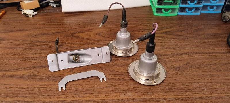

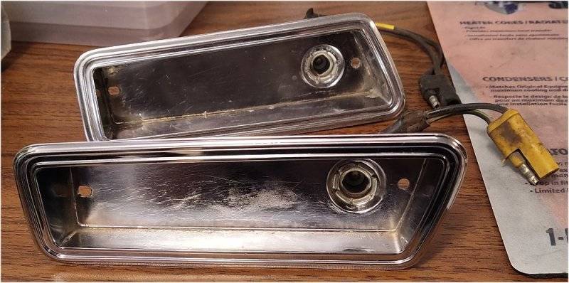

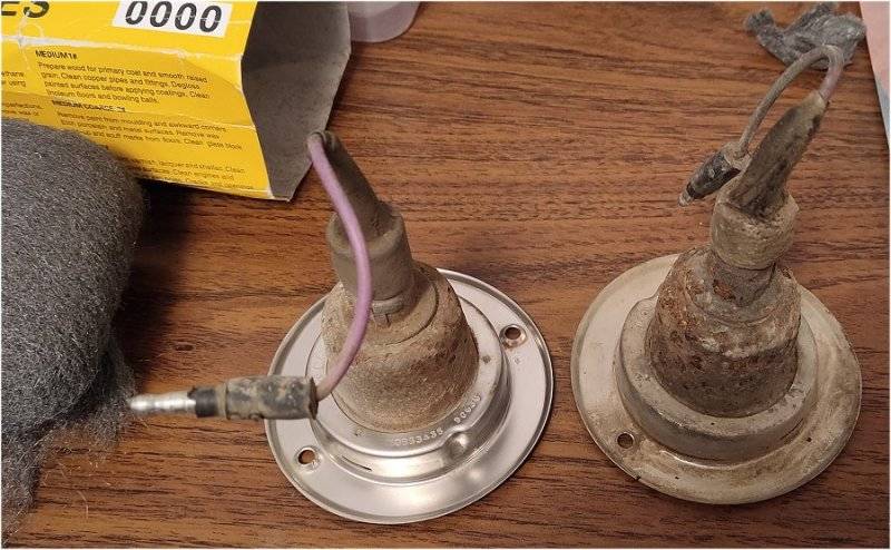

I did my best to restore the reverse and license plate light housings. They were intact other than being rusty and cruddy. Even though the housings won't be visible when installed, I didn't want to simply reinstall them in this condition, so I sanded/filed off most of the rust and crud, degreased, then applied a few coats of Rust Bullet. I chose this rust converter paint for these parts because the slightly metallic grey finish looks quite similar to the original metal. Gloss black wouldn't have looked right or be as reflective, as far as the license plate light housing goes.

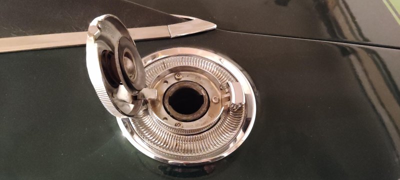

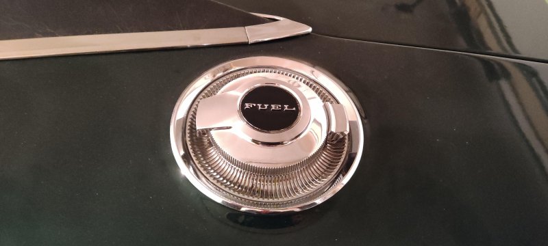

I'd been putting off reinstalling my fuel cap because I wanted to install those anti-theft screws that need the special socket doohickey to install & remove them. Unfortunately, everywhere I searched on eBay, they were ludicrously priced at $26+ USD, which ends up being an asinine $50 - $60 CAD north of the border...for 3 frickin' screws and a socket! I found a much more affordable, almost as theft-resistant solution on Amazon. These #10 x .75" stainless Torx security screws were perfect. Plus, you get 50 of 'em AND the screwdriver bit to install 'em. You could do 16 gas cap installs with these, for a mere $18.49 CAD, shipped.
https://www.amazon.ca/dp/B0DHCYC2TC
Perhaps not quite as theft-proof as the funky ones, but most thieves aren't walking around with Torx security screwdrivers in hand, so this option should do the trick.
When I bought my car back in 1986, the hood signal lights didn't work, and the passenger side amber lens was completely missing. Today, I went to install my housings and repro lenses I bought several years ago and discovered this...I've heard about repro parts quality being dodgy, but aren't these lenses supposed to fit better, without that huge gap along the upper edge? Am I missing something here? I can't believe these repros would be THAT ill-fitting! Has anybody else experienced this? If these are just a janky set, what repro lenses ARE a proper fit?
Amazon.ca
View attachment 1824304 View attachment 1824303
I recommend using machine screws with lock nuts for security. You would need access to the trunk to remove.

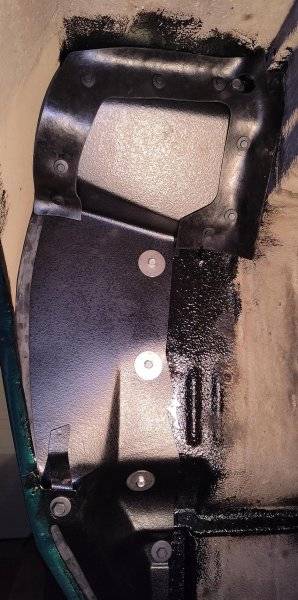

My passenger side inside fender rear splash shield was rusting out and the rubber piece falling apart. The driver side isn't so bad, but I bought the set of both and fasteners.

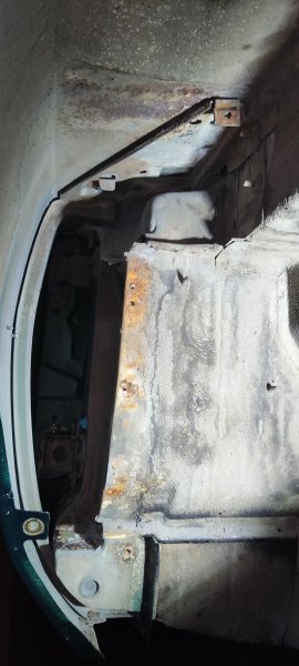

I was kind of dreading what I might find behind that passenger side splash shield...
Removing the 3 bigger bolts was easy, but I found the handful of smaller fasteners much more of a challenge. The heads are very shallow and difficult to get a grip on with a socket or Vise-Grips. I was concerned that I'd round off the heads because they were stuck in there pretty good. Looking at them, I think the very thin, round washers under the bolt heads weren't helping as they just increased the surface contact area and were likely rusted to the bolt heads, so here's a tip that worked for me: smack on those washers and all around them with a hammer. This must've jarred them loose because I was finally able to remove those shallow fasteners with a socket.
What was revealed behind the shields wasn't as bad as I thought. Some surface rust in places and a rusty mounting clip at the top, but a good wire brush, degrease and DOM16 should preserve that nicely, before reinstalling the new shields and rubber pieces.
What I wasn't expecting was each of the original splash shields had a strip of rubber weatherstripping of sorts pinned along the edge facing the curved inner fender. I don't recall seeing repros of those anywhere. I hope treating them with some Aerospace 303 Protectant and careful removal, I might be able to re-use the original rubber strips.
National Moparts should have them. Purchase the kit. They are made buy DMT.

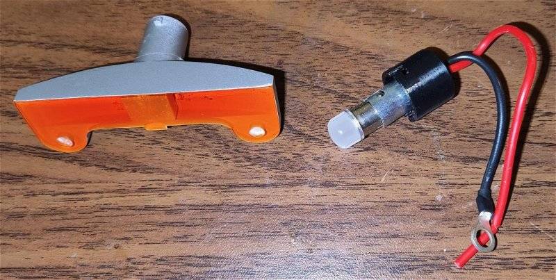

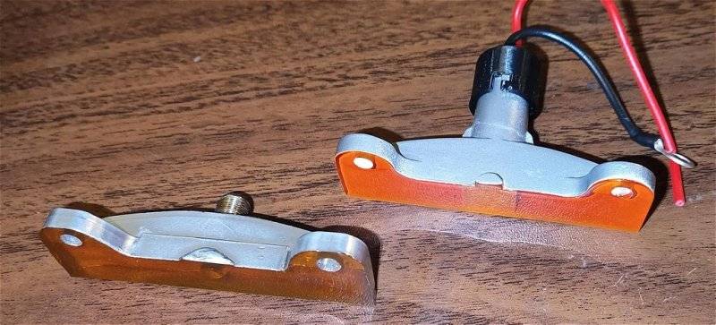

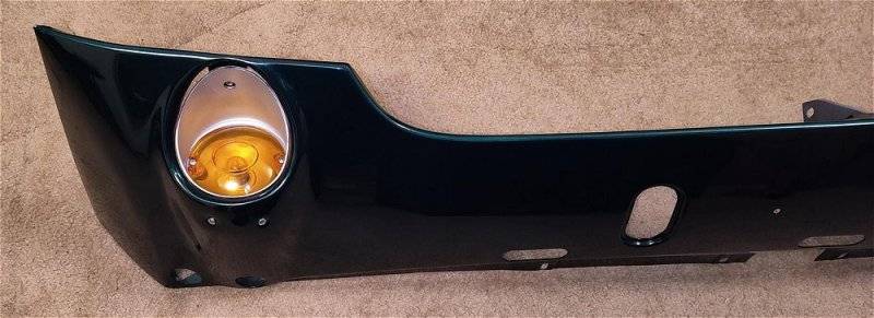

This post will serve as a comparison of Canadian1968's custom hood signal lenses for the '70 Charger and some repro units I bought several years ago. I wish I could remember the maker of the repros but I believe they're the ones commonly available on eBay. The difference in quality is noteworthy.
The repros have pretty low-quality moldings of the lenses themselves, the surfaces look wavy and have molding marks or lines that almost look like scratches, but that's how they're molded. These repros are new, right out of the package and haven't been installed on my car yet. I just test-fitted them to the housings. I just want to show that these weren't marked up by installation or shipping, this is exactly how they look.
The surfaces of Canadian1968's lenses are perfectly flat & smooth and the mounting holes are perfectly round, not ovalled-out. The pigtails use an LED bulb which should be brighter and last a lot longer than the filament bulbs used with the repros. Another issue I found with the repros is the knurled threaded socket on both doesn't fully thread on all the way; I suspect this will result in the metal grounding tab that's retained with the socket not grounding securely, unless there's a washer or something added. The filament bulbs are also stuck in there pretty good, I wasn't able to pop one out with a fingernail, so replacing those filament bulbs might be a hassle compared to the twist-and-pull type socket and pigtail with Canadian1968's design.
All this said, I highly recommend going with his hood signal lenses if you need them, and avoid these repros!

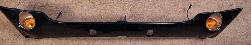

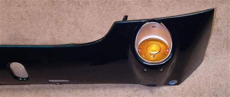

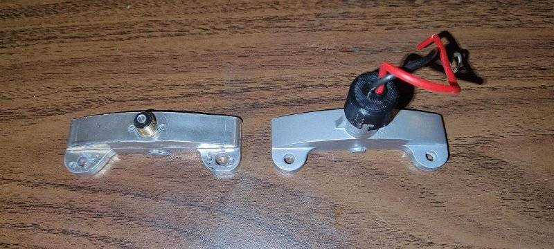

I installed new park light lenses on my original housings that I previously restored, cleaning them up and painting them with Rust Bullet, which has a nice silvery-grey finish. I need to point out that although the metal housings are marked "L" and "R", the lenses aren't, and it's all too easy to install the lenses on the wrong housings. This will make the park lights impossible to install correctly in the valance, the 3 screws won't come close to lining up. So make sure not to replicate my error and be sure to install the lenses on the correct side housings before mounting to the valance.
Looking closely at just the lenses, the driver side one leans a bit to the left and has more plastic on the left side; the passenger side lens leans to the right. Although it's a bit hard to see from my pics, if you look closely at the center mounting hole on the top, you can see the oblong oval is more weighted to the left on the driver side; and more to the right on the passenger side.

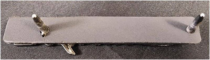

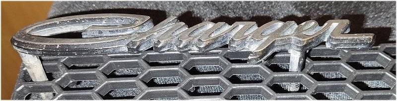

Took are of a small but essential detail today. I had to figure out a way to reinstall my Charger emblem onto my custom grille. The original grille had a thick plastic mounting plate with holes to fit the emblem, but my aluminum hex mesh grille lacks any way to mount the emblem. I decided I would need to make 2 emblem base-plates to sandwich on either side of the grille. I also didn't want to change anything with the emblem's original mounting posts, which aren't round; one side has a metal runner that helps align the emblem in the original plastic. I cut out a piece of some leftover plastic grille mesh I had laying around from a grille mod I did with my Magnum, and trimmed it down to back the emblem nicely. I added the notch for the runner on the right side of the emblem. This part will go on the outside of the grille hex mesh
For the back side base plate, I cut out a piece of spare 3mm Kydex, drilled a few holes and added the notch for the runner.
Here's how it looks prior to installation after cleaning the crud between the letters with WD-40 and a toothbrush:
And finally, bolted onto the custom grille with the speed nuts and making sure it's level with the "500" emblem:
Here's what you need to completely replace your fender inside rear splash shields. In addition to the obvious metal shields, fasteners and the U-shaped rubber gaskets at the top, make sure you also get those long weatherstrip pieces that are pinned vertically along the outer edges to seal against the inside of the fender. I gave these a good scuff and sprayed rocker guard liberally on the shields.
This pic shows the inside of the fender and firewall where I wire-brushed, degreased and applied DOM16 wherever it was needed, prior to installing the new parts:
And finally, the new splash shields are installed. One issue to note is the repro fender shield gaskets at the top don't snap in firmly at all with the included mounting pins. The holes in the repro splash shields might be a tad too big. You could literally pull them off without much resistance. That's a far cry from how firmly rooted in the original worn out rubber ones were when I tried removing them. I needed a big flat screwdriver and even a claw hammer to yard those off the rusty old splash shields. I may need to screw in a few sheetmetal screws to make sure they stay in place. Has anybody else noticed this?
