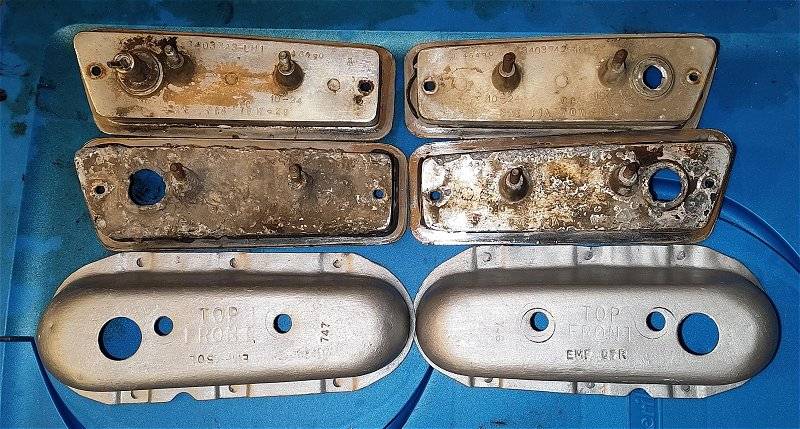

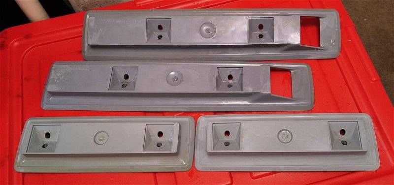

Ahh, armrest bases...I have 2 or 3 sets, but why do they all look like this?
Since not all of us can afford expensive shiny plastic things to replace all the parts on our cars, I wanted to remove the chrome on these and paint them. I tried sanding off the chrome from one and what a righteous pain. I got about a third of the way done and gave up. There HAD to be a better way to de-chrome ABS plastic. I've easily removed chrome from nylon parts for RC cars with an acetone bath, but that won't work with ABS plastic, it'll melt the plastic.
I found a Youtube vid of some modeler who tried LA's Totally Awesome Cleaner to remove plating from plastic model parts, and since it's cheap as dirt--$20 CAD for a 64 oz (nearly 2 liters) jug, I thought I'd give it a try. I put a pair of small armrest bases in the bath for a few days--one day to do the tops, one to do the bottoms, so as not to waste too much of the cleaner. Lo and behold, nearly all of the chrome either was dissolved, or easily wiped away with my finger. What remained, I used some 0000 steel wool and it all came off.
Now the bases are ready for some SEM Trim Black for a satin finish.

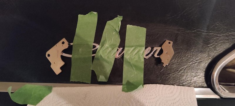

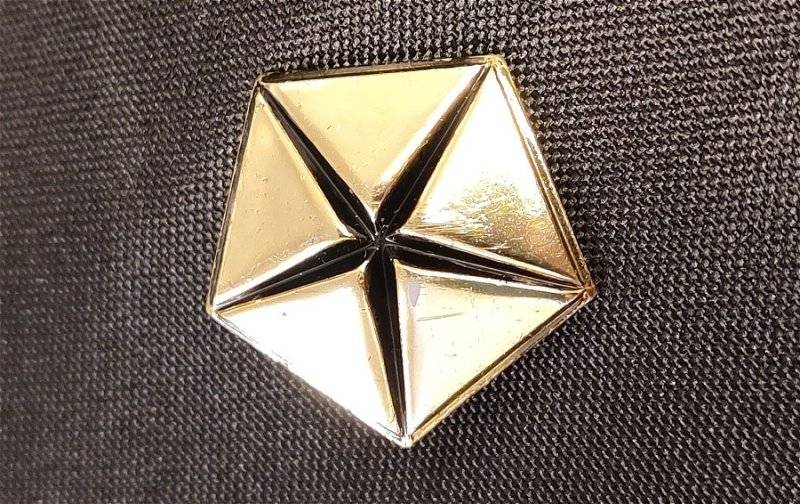

Since chromed steel is a totally different process than ABS plastic, I didn't think the cleaner would harm the chrome, I thought I'd do a test and soak a "Custom" metal chrome emblem to see if it would remove all the crud and crusty, flaking-off black edge paint. A day later and the black paint was coming off with a fingernail. A soft brass bristle brush took care of the nooks & crannies. So, into the bath went my "Charger" sail panel emblems. 2 days later:
These turned out so nice, I don't even think I'll paint the black edges before I reinstall these. It seems a shame to hide that nice chrome. I know it's not original but less and less of Grendel is gonna be original, so no worries. I actually think the full chromed emblems will stand out even nicer on top of my black vinyl top.
