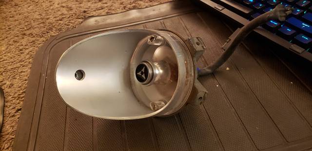

Another question: I'm test fitting the lower valance tomorrow and I just realized that the turn signal lights have two holes on the ventral side. However, my lower valance doesn't have holes that match those two holes on the turn signal light. Do I have the wrong valance, or something?
