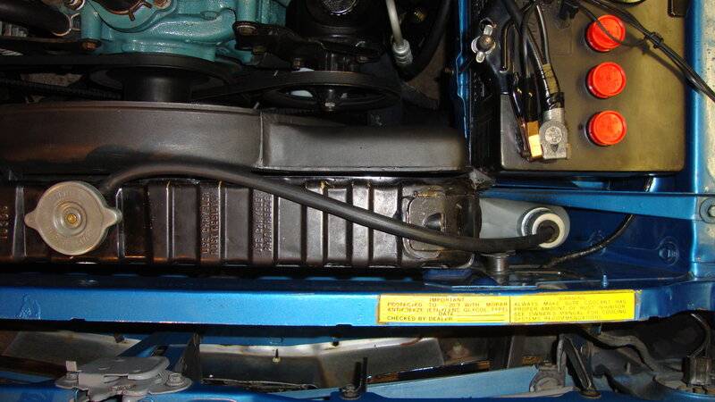

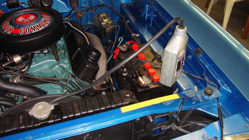

Here is what I did...cheap, barely noticeable and works like a charm.
View attachment 1179150 View attachment 1179151
I like it.
