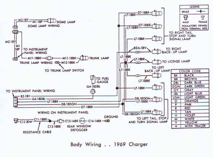

Can someone tell me What guage wire is the tail light harness for 69 Plymouth satellite ?
thanks!
85% of the car wiring is 16.
BUT Tail lights harness is 100% 16 LOL. Including the body harness from kick panel up to trunk
well, by bad, it seems they are actually 18 gauge, but it doesn't hurt get them in 16.
( Charger diagram posted, but must be the same for rest of B bodies except for the qty of tail bulbs )
I used the 16 …can’t hurt. Wrapped the small splice in harness tape and you can’t tell anyway
