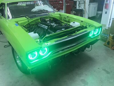

@biomedtechguy I figured this was next on your list of mods, lol. Octane lighting H4 style sealed beams with LED bulbs.

I put LED lights in this year as well. The Halos are from years back.
1A4EB328-E1E8-43C4-BAAF-01F752DD39FF.jpeg 79F6716B-8082-4FA4-AF36-2E0370BAF73C.jpeg 25A4D824-966E-46AF-9283-A8277ECE7DA3.jpeg
