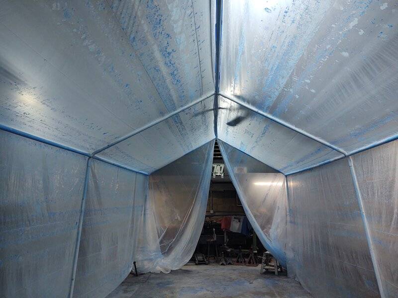

Harbor freight makeshift paint booth..
Hey wait a minute..... where are the pictures of the make shift paint booth with mods?!?!
Well.. I didn't figure you'd need a picture of a tent framed carport lol. I was just passing on the idea.

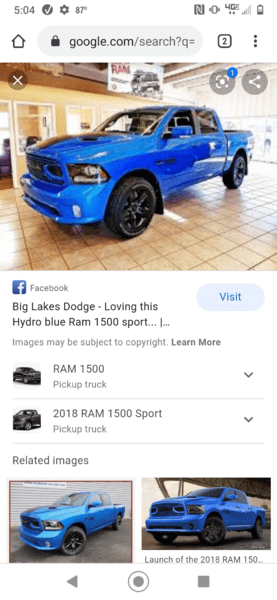

I've never done it this way but wanted to try it, a truck seamed like the best candidate? The color is PBJ (Hydro blue), it's a new RAM color. I'll be adding some flat black following body lines once it's assembled, hood center and from the bottom body line down. I chose this color just because of how good it looks with black and knowing my dad isn't going to polish anything... I'm not giving him something that needs polished lol.

I've never done it this way but wanted to try it, a truck seamed like the best candidate? The color is PBJ (Hydro blue), it's a new RAM color. I'll be adding some flat black following body lines once it's assembled, hood center and from the bottom body line down. I chose this color just because of how good it looks with black and knowing my dad isn't going to polish anything... I'm not giving him something that needs polished lol.View attachment 1005833
I was wondering what color it was. It is going to be very nice on the truck..
