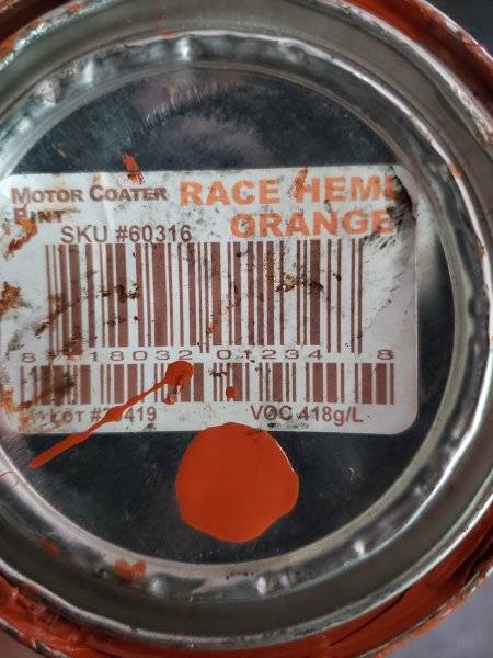

i used a motorcoater brand , i forget which color exactly. i brushed it on stuff is tuff as nails. i can look when i get home i still have some. fairly inexpensive
Hubbarocks that looks great, AND looks like race hemi orange. I looked at the KBS motorcoater stuff, and would definitely try it, but they don't list "RACE" hemi orange, and if their hemi orange is for 68up 383, 440, and 426, it's way off of the color I need.

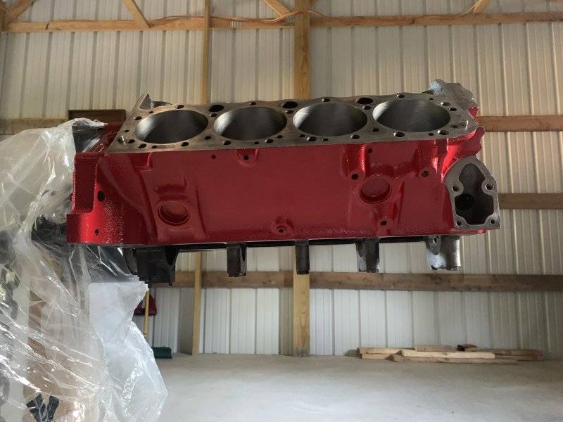

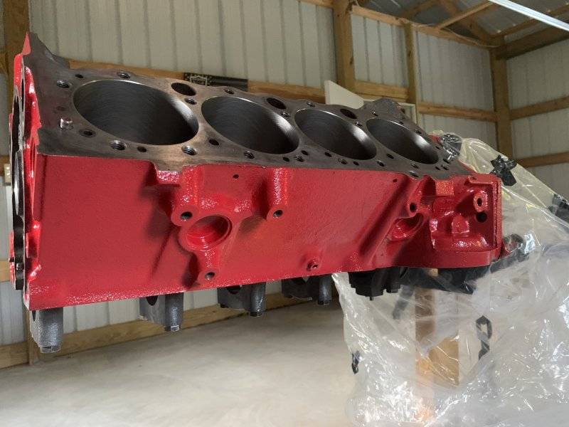

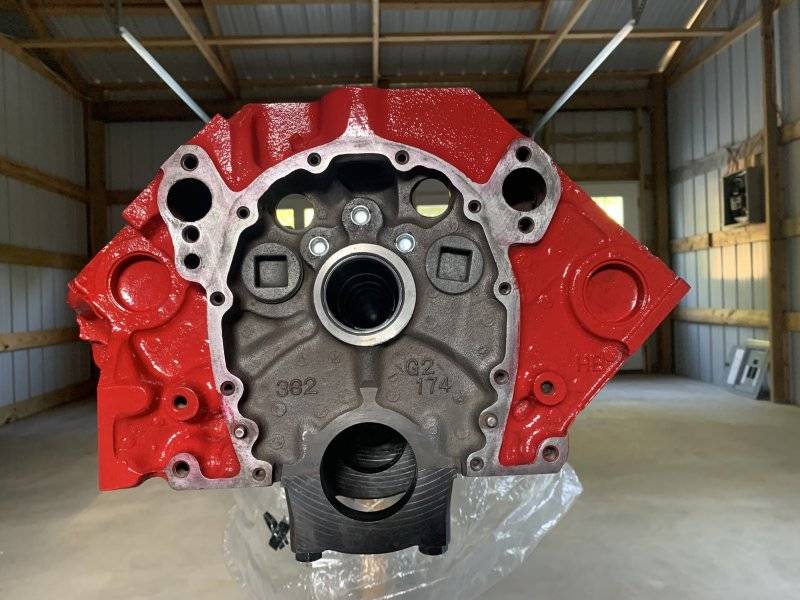

This is the primer and paint I brushed on after using a small propane torch to dry the moisture from the block. The primer and paint was on the shelf at Lowe's. The block is a 327 Chevrolet but according to Uncle Tony (Uncle Tony's Garage) Omaha Orange is a great match for Mopar Orange but can be ordered by Lowe's if it's not on the shelf.
Hubbarocks, you da man! Thank you so much! When I looked at KBS's site, I didn't find that! Gonna order a couple pints today!
Might be on the late show. But I confirmed it's the race hemi orange I used. Love this color

Question: Are there any areas which you would avoid using Tony's "torch" method? Im thinking you'd want to avoid the freeze plugs.
Yes, I avoided the freeze plugs but that’s all on the bare block you need to watch out for.
