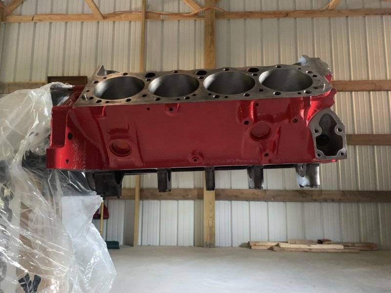

I just brushed a 327 block with rustoleum rusty metal primer then gloss sunrise red paint. Omaha orange is very close to Hemi orange.
Here is a link from where I got the idea.
This is what the block looks like afterwards.
