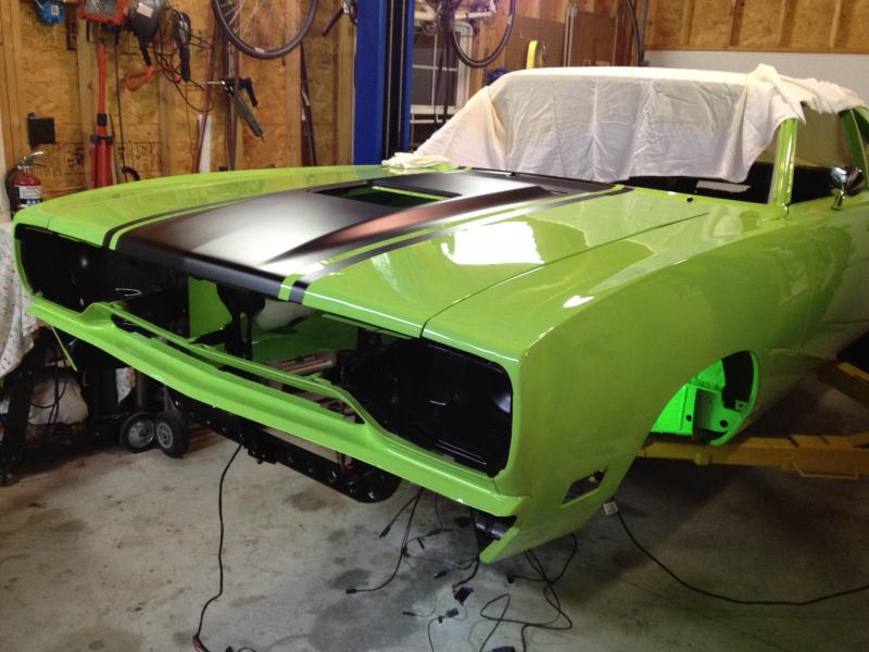

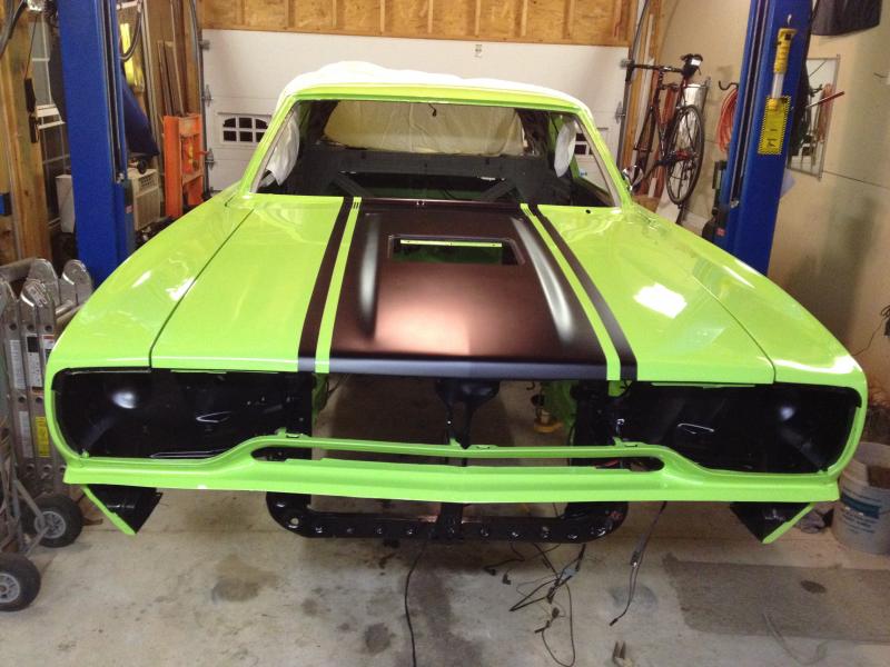

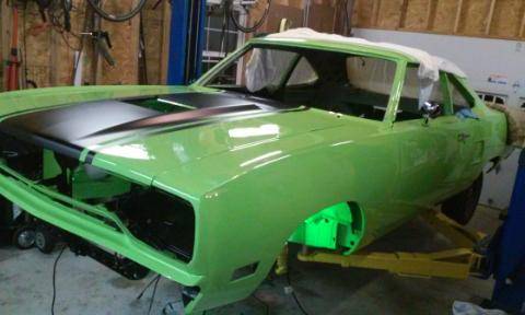

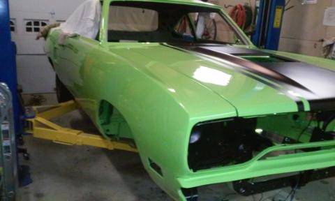

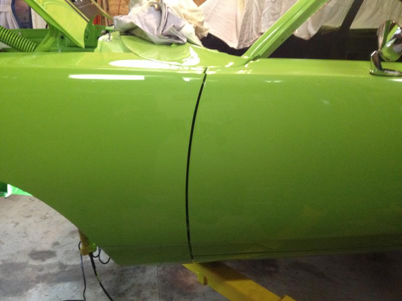

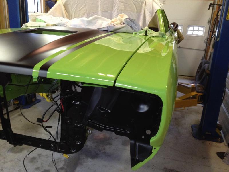

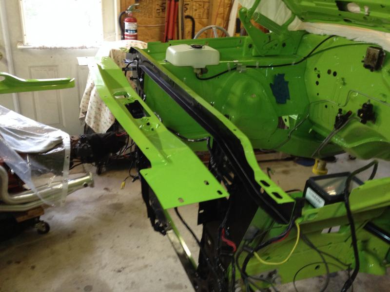

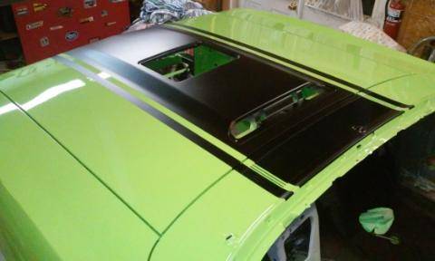

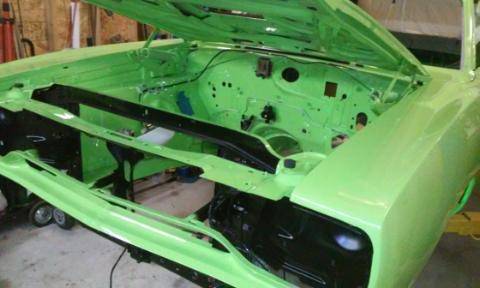

We busted a$$ all day and the pictures below show what we ended up with. We spent A LOT OF TIME messing with all the body lines and gaps. You definitely can't just throw these front ends on the car. An adjustment in one place creates changes in another, so you have to go through an iterative process to get them all right. But now the body lines and gaps look great. We might tweak one or two as we finish other items, but at this point it is splitting hairs.

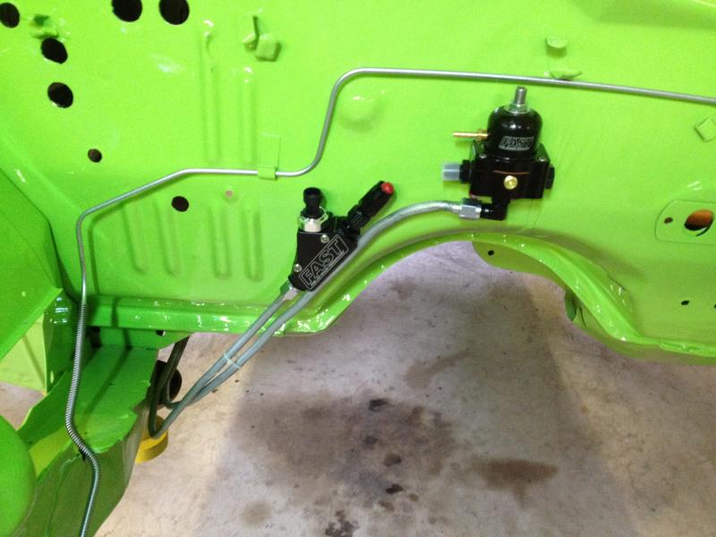

Oh yeah: My 90* fitting also arrived, and I messed with the return fuel line a little bit. The line still needs to be cleaned up a bit, but it looks like it will work OK. Here is what it looks like at this point:

First class! Cant wait too se the finished product. Did you have any paint marring issues when installing the fender bolts?
some of the bolt heads will need minor touchup.......... the factory obviously painted everything assembled
