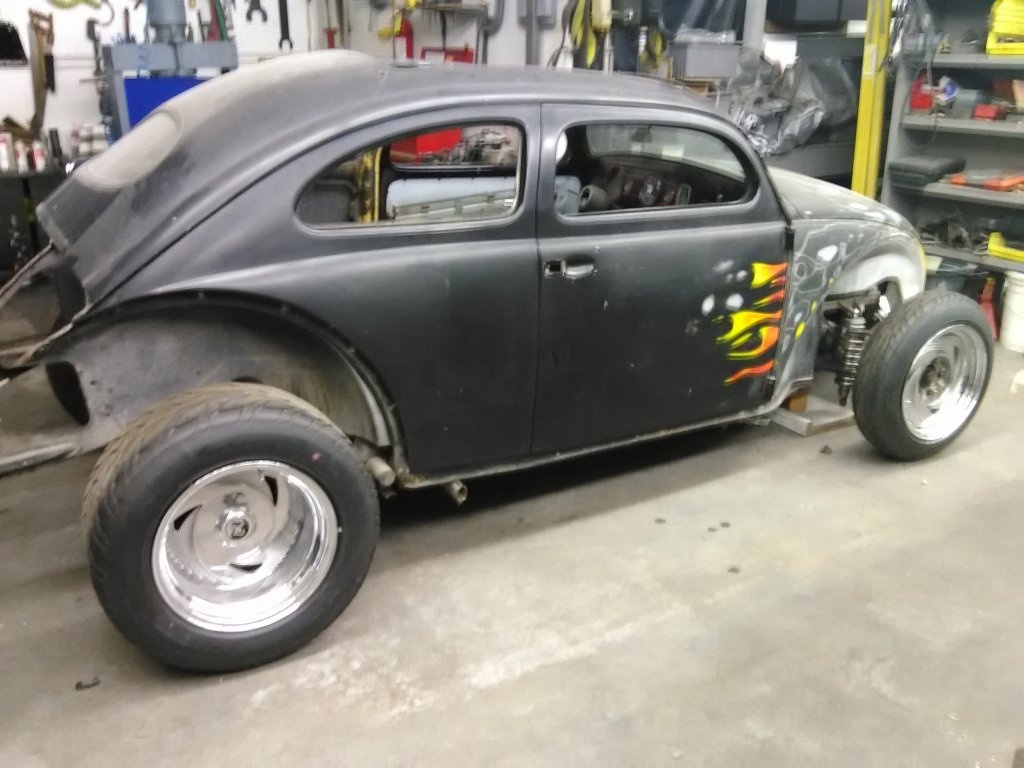

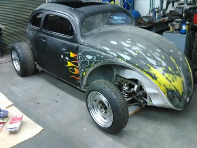

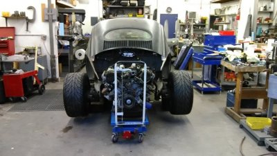

Spking of gears, the bug has a 67 911 S t-axle init....decided to look on ebay to see the general ask.....i definitely do NOT want to break it.....10-11K on avg.....good news is they are good for 350 lbs tq as long dont stand hard on in first, and of course no clutch abuse, speed shift..
Im super diffing it, beef ring & pinion & kicking the final drive to the moo maybe 2:10.....make the power nice & usable, long throttle travel, keep the nose down, with radi, oil tank and coolers,,little added dead ballast, i think ill get a 55r-45ft bias, no worse than 60-40.....im really going to try for Bonneville next year.....strictly fun, have always wanted to go, now i have fun car, what better way to exp it? A couple decent angles here

Your bug is cool as hell with some really neat work on it; I'm enjoying your thread. BTW, I thought I heard that the salt flats were having some issues and conditions have not been good to drive on it for a couple of years. You might want to check before you go!!!
