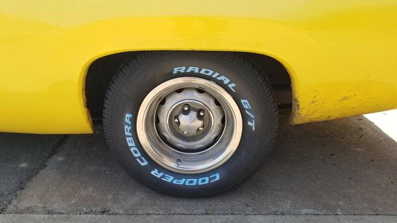

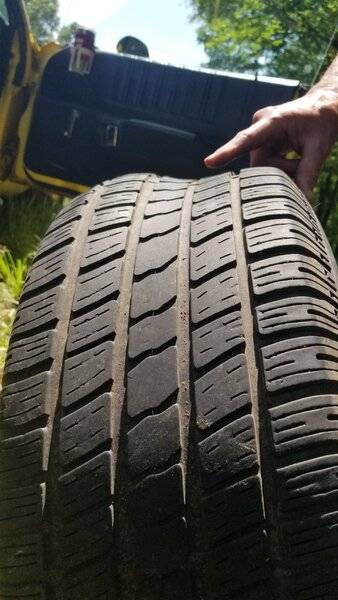

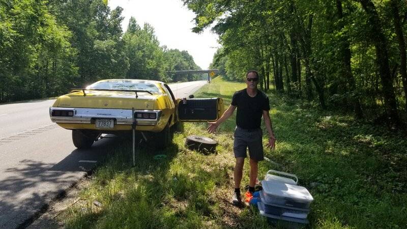

  2. We decided to drive highway 40 to quickly get to Hot Springs. Well, the rear tire had other ideas. Looks like the belts suddenly let loose. So we ended up on the side of the road putting on the spare while huge 18 wheelers went blasting by us. Then I had to order 2 rear tires. Should be in by tomorrow. $500. Ouch

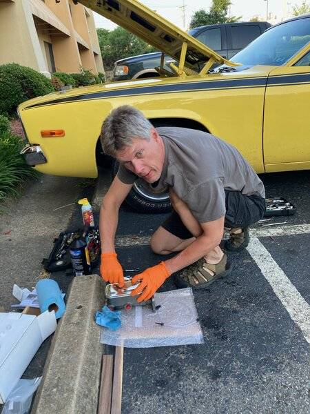

  3. So we go to pull off the highway and the brake pedal feels funny. It goes (partially) to the floor sometimes but other times works well. We check the fluid but no loss of fluid. Must be the master cylinder. So we found one and bought it. $100
So tomorrow morning we will try to swap out the master cylinder before 10 AM. Then we will drive to a Firestone tire center and get two Cooper tires for the rear of the car.

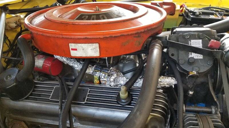

Haha. We did use zip ties! To put rubber fuel line (cut length wise) over the fuel line along with aluminum foil to try and stave off vapor lock whenever we stop. No pictures yet, but I'm not sure it really helped.. :mad:

When you don't have a bench, I guess this is bench bleeding then?!?

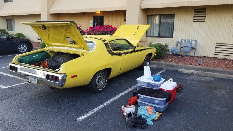

Lots of stuff to unload to get to tools needed. Note also the small spare in the back.
The master cylinder has been replaced. Brakes are good, but we didn't bleed them since we worked hard to minimize bubbles in the lines. I'm sure if we bleed them they would be even better, but we will see if we can do that at the Firestone center when we get tires.

Old school ---Try some of the campfire aluminum foil until you find what you want! Put it on loose. It worked at the drag strip in the 70s!!
Thanks for the suggestion - we did try this, although with split 3/8 fuel line first and then aluminum foil. We repurposed an old can to go around the fuel filter.
Unfortunately it didn't seem to improve the hot starting, but it was worth a shot!
Overall though, engine is running well except for the hard starting.
Mercy. Praying you guys have an easier go of it from here on out!
On the carb issue - you sure it's "percolation" that's the culprit?
If so, that big ol' factory air cleaner is quite the heat trapper itself - maybe try a cheap
aftermarket little chrome jobber in its' place and see if things improve?
