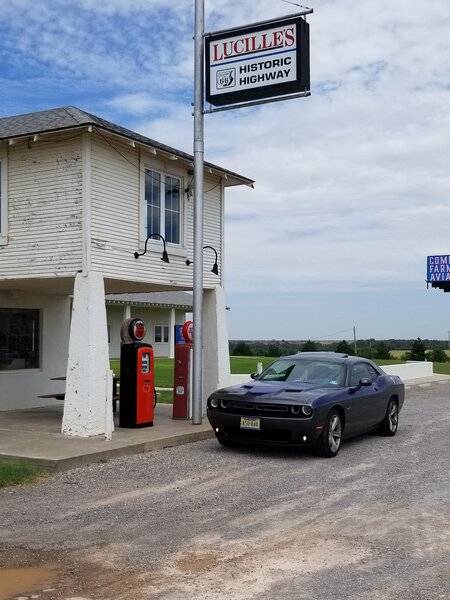

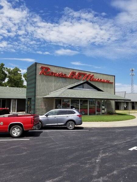

"...ON THE ROAD AGAIN..."!! IF going down to RT 40, some RT66 stuff in OK, "PONY BRIDGE" near Geary, road opens back up May 8th, Lucilles Old time gas station near Hydro, RT66 Museum in Clinton, pretty neat stuff if into "things" like that. Once in a lifetime thing I HAD to do.
