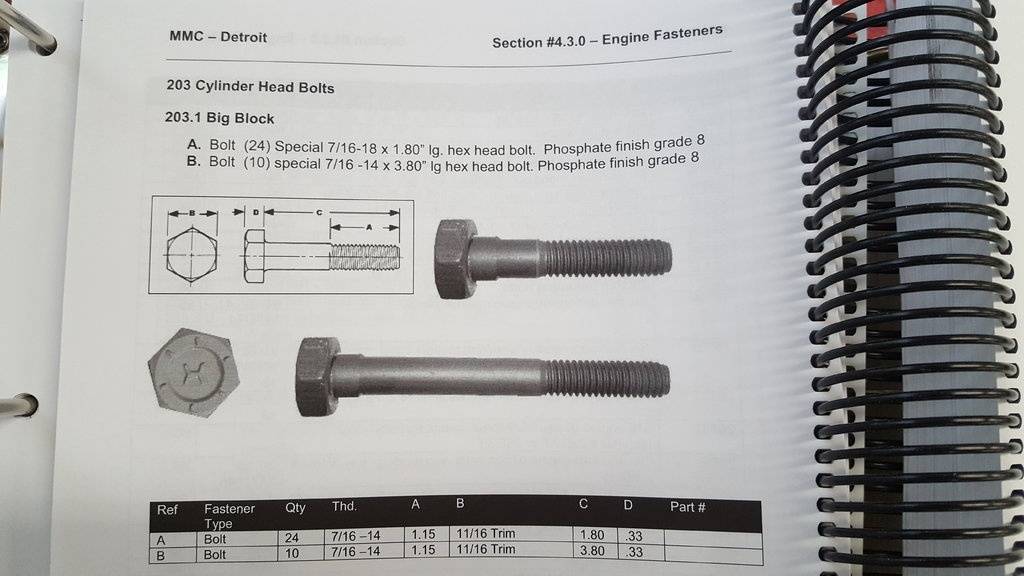

No washers on the OE bolts. Make sure you measure their length before going ARP.
No washers... Here are the correct measurements.
I'm running washers on my motor for not good reason other than they came with the cylinder head studs. Stock motors don't have washers. I "think" they're important to use when you have aluminum heads (so you don't gouge the heck out of them with hardened steel head bolts). For iron heads...."maybe" a little more even torque, but Ma Mopar's engineers didn't think they were needed.
