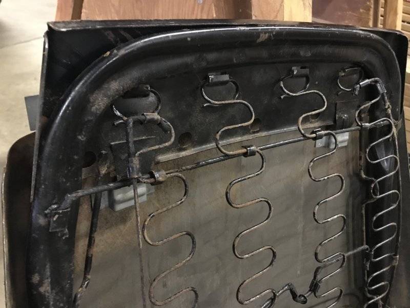

I'm also looking at this as a project. This is from a 66 Satellite bucket seat, as shown there are zero provisions for adding headrests. I also have a pair of 66 Charger seats that are identical, zero provisions. Could someone post pics of a 67 seat frame showing the factory headrest provisions for the OP and many others? TIA.
My bets are the 67 had a different frame and 66 has no provisions to add the headrests.
