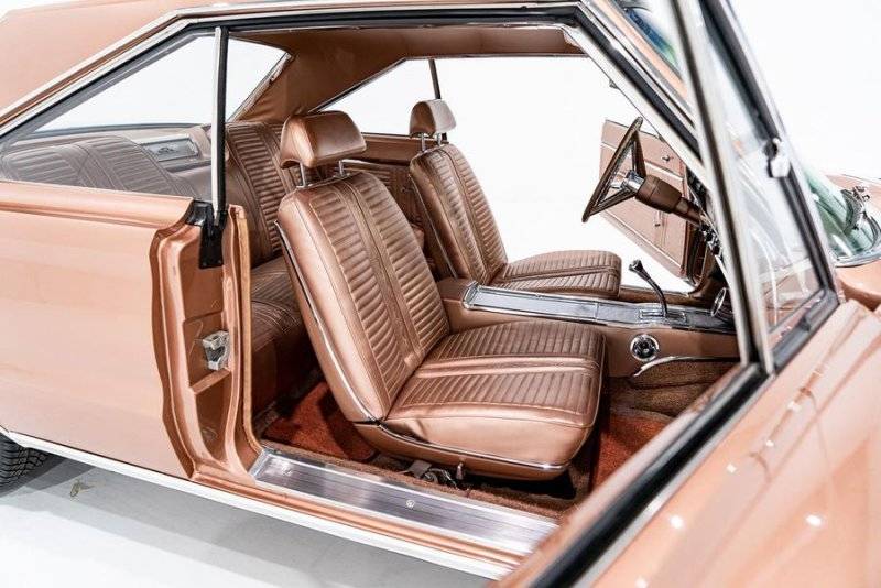

Head rest for 1966 with bucket seats

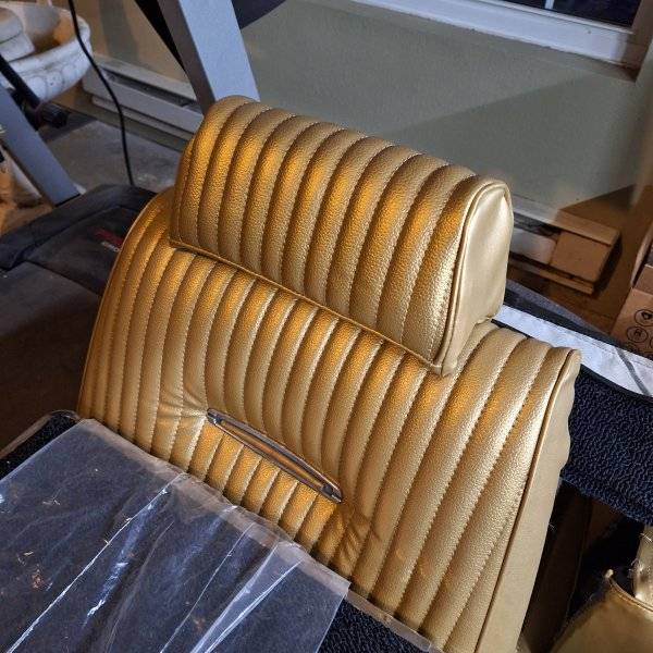

The pic above is mine (the one redbeard posted) I do have one more set left of those headrests if anyone is interested. Not sure what they are off of but they are dark blue. Can dye any color. You will have to modify them with a donor set of posts from another junk set of headrests…..that and a welder and piece of steel is all you need per headrest. Easy peasy…….once installed, they look awesome and most won’t even know they are not the expensive originals….. I also aH e a set of originals but not sure on selling yet. They are super expensive. And Rare.
Yeah almost went that way but decided to be patient and keep looking for originals. Luckily found a set. However, I have some extra headrests if someone wants to do a project with Suregrip391's parts.

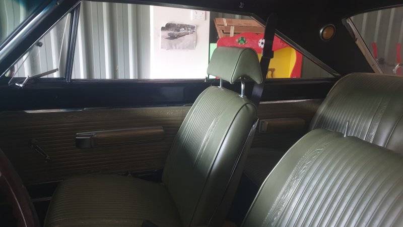

This is a photo of what I'll be trying to achieve when I finally get back on to it. I might end up custom making them - I could pick up a couple of modern headrests for about $20 from the scrap yard and then widen/lower them as required.
Those look great. Good luck.
Yeah, shape to fit and then cover with matching upholstery fabric.
