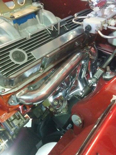

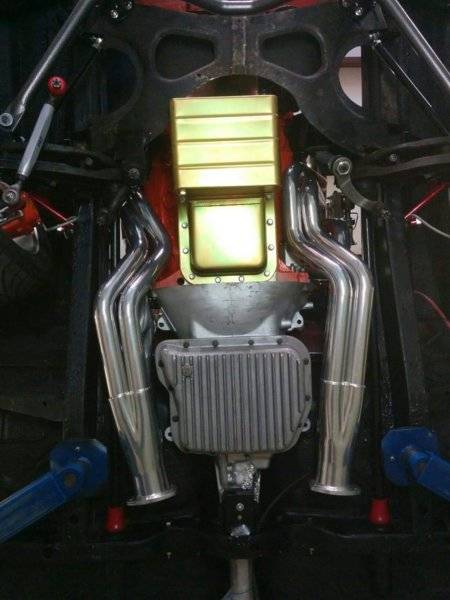

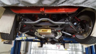

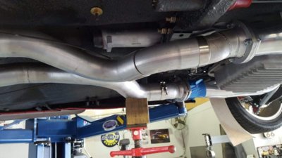

I suggest visiting tti online....I put tti 1 7/8” polished, ceramic coated,thermal barrier headers on my 65 Coronet , they fit like a glove! Remember, MOPAR is all they do, and they got all figured out...I also went with tti 3” pipes all the way back, including the “X” pipe....very nice stuff
