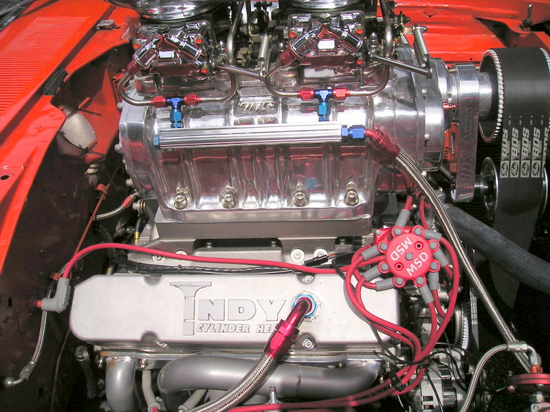

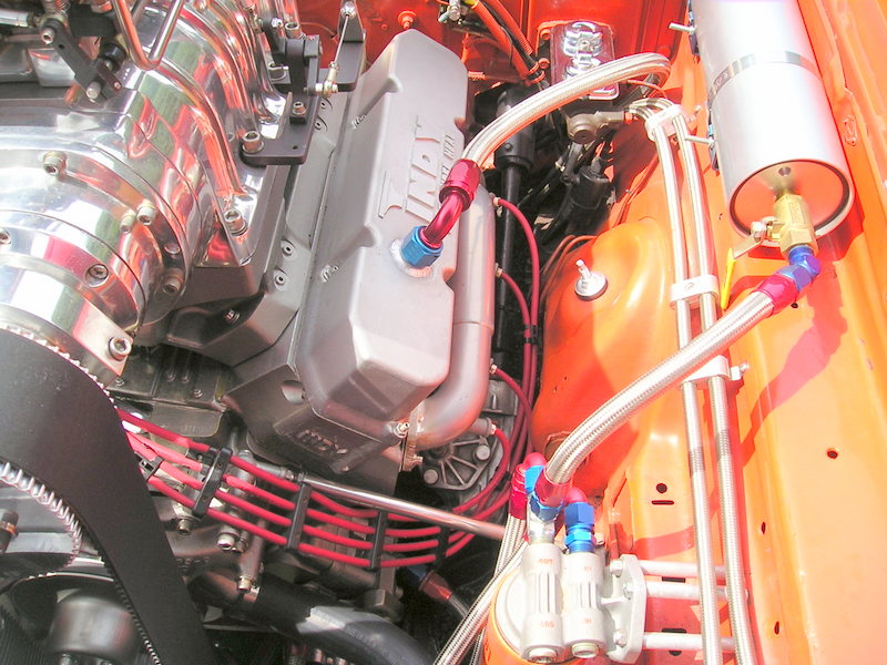

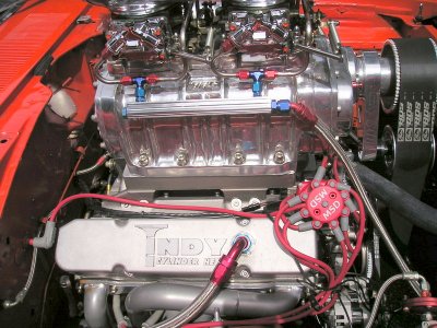

Ive run hookers , hedmens tti , tti seem to fit the best and stayed looking making 825 hp good running 3 1/2 collectors to 3" pipe, x pipe / flowmasters a little frosting on the middle tubes but that was a tunning issue, its not easy tunning two 850 holleys on a 871 super charger tti step headers, good stuff Picture 390.jpgPicture 391.jpgcaridy5-R1-006-1A.jpg
