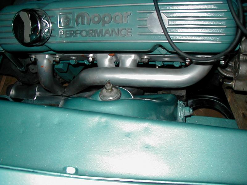

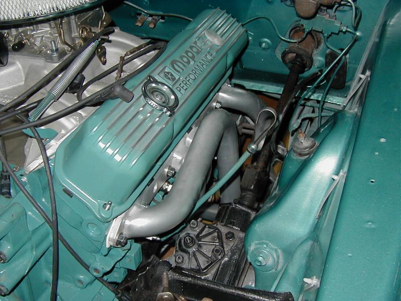

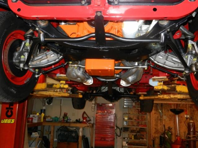

I have the Headman Elites on my 63 and they do fit, had to make one small ding for the mini starter, they are mounted on a 383

Thanks. That's what I'm lookin for. PROOF. Nice lookin engine. Can you post an entire shot?
