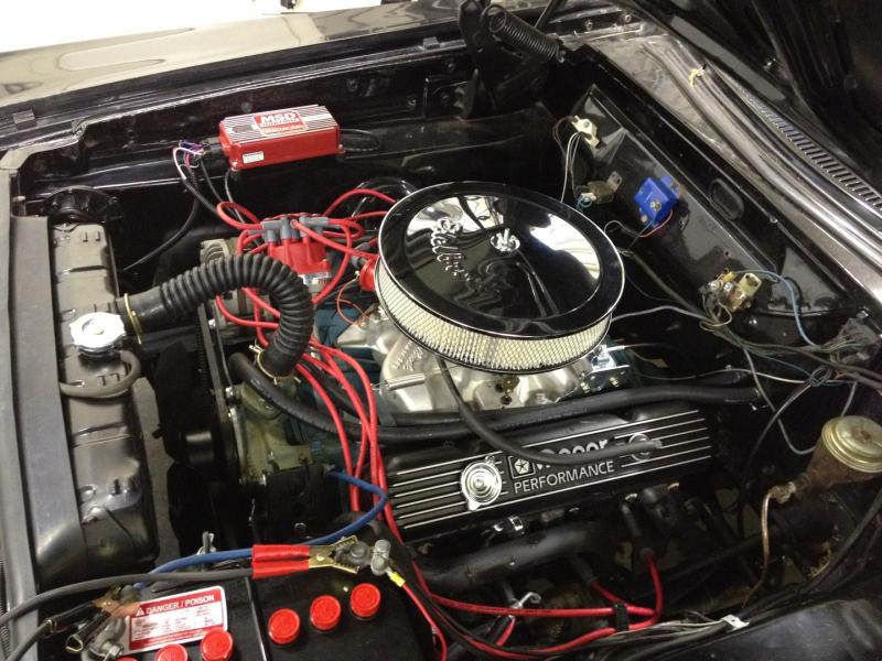

Here are the Hedman 78030 in a 65 Belvedere II.

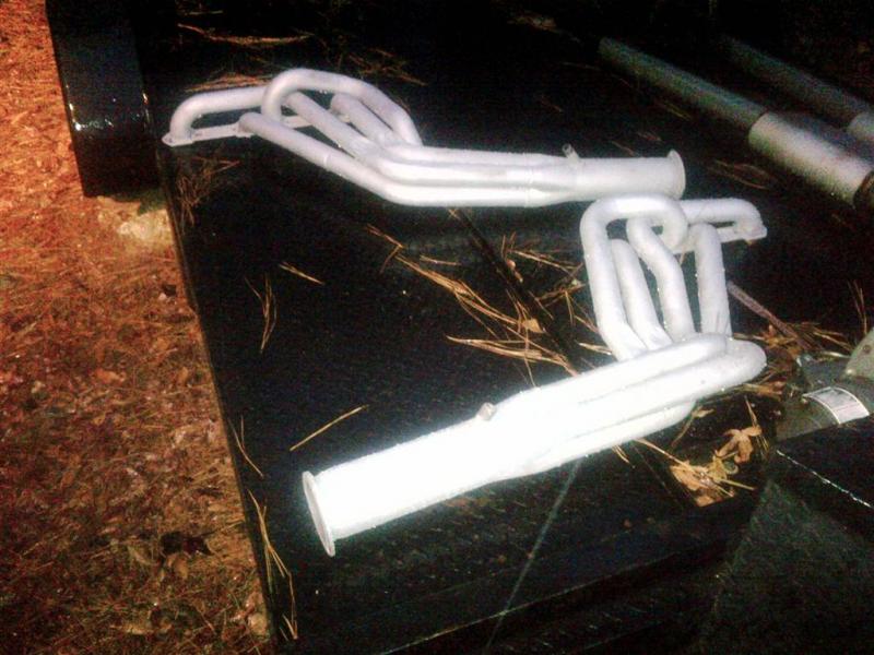

Here they are off the car..

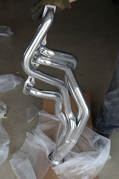

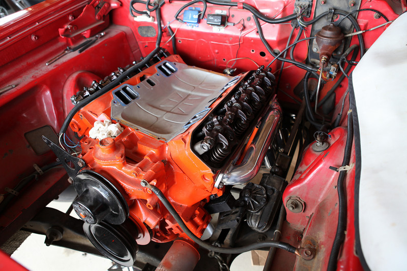

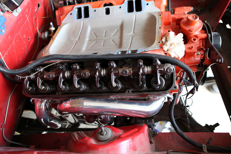

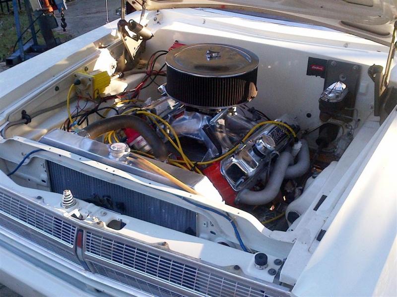

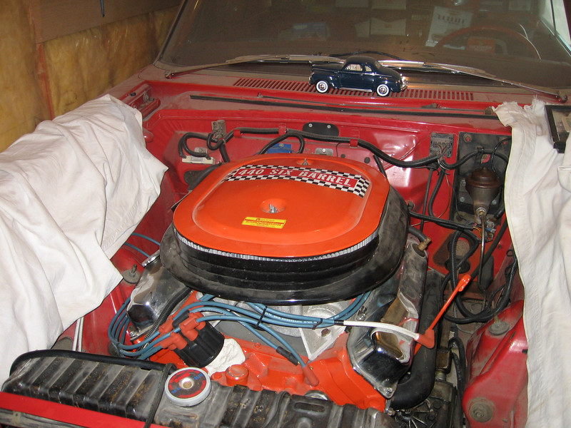

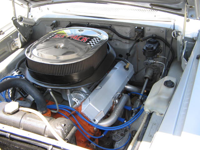

My 64 came with hookers and they didn't clear the steering and were a real pain to get out. The tti headers on the other hand fit really nice even with the big starter (now replaced with a mini) and are well worth the money. The first pic is with the hookers and the rest are of the tti's being installed. I forgot to add that you'll want stiff mounts or a torque strap of some kind as there isn't much fender clearance on the passenger side with the 440 in there as you can see.
