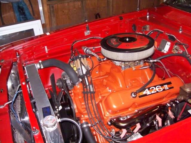

tti ceramic coated headers on my RB blockin the '63 belvedere...and we have TTI on the HEMI...67 dodge R/T
both 4 speed cars and have mini starters.....BIG diff' in power!
BTW; they both are Red, Poverty caps,
They're Real and They are Spectacular !
(headers are like implants)
